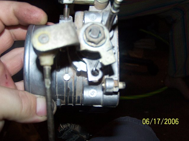

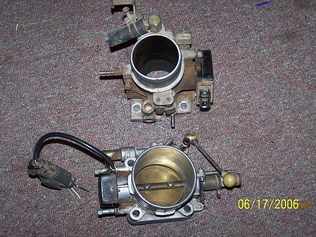

Hear are a few pictures of what i did... or at least what i thought was right... tell me.. the truth... did i mess up ?

yeah... you just have the ball 180 degrees off... undo that nut & rotate that bracket 180 (keeping the ball on that same outward side).

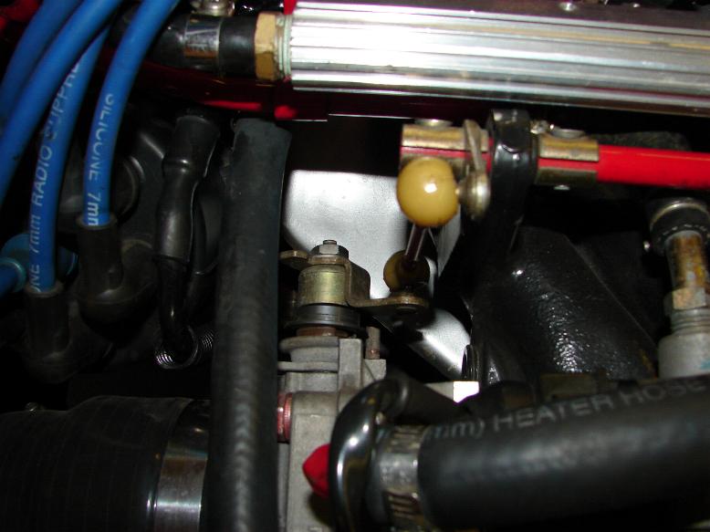

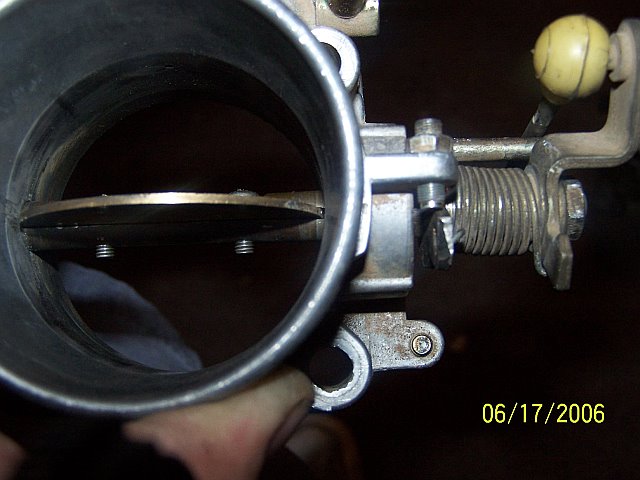

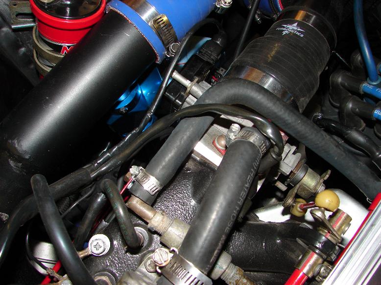

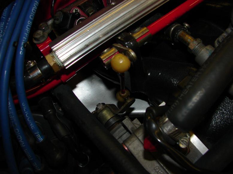

K... here's 4 shots of my 60mm tb.
Attached Thumbnails 1996 240sx throttle body ?-dsc00841.jpg   1996 240sx throttle body ?-dsc00842.jpg   1996 240sx throttle body ?-dsc00843.jpg   1996 240sx throttle body ?-dsc00844.jpg
Old Jun 18, 2006 | 07:56 PM
nismo619's Avatar
Posts: 1,271
From: z junk yard
nismopick what year 240sx did u get yours off of ? becuase im having problems trying to do what u did it seems like the 240sx shaft is way to long for the linkadge..
Old Jun 18, 2006 | 08:11 PM

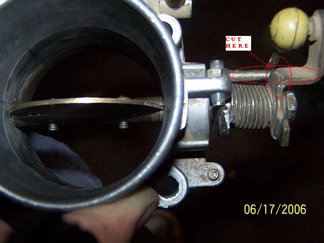

One thing you need to do, is cut that bar holding the springs. Cut it down, just below the ball linkage plate, and keep the first spring on. That way, you can flip the linkage plate 180 degrees to where it should be stock. See attached pic.
Old Jun 18, 2006 | 08:16 PM
BTW... if you look at my previous attached pics, you can see that I've done that.
