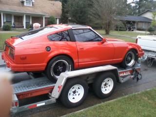

OK, it's been a long times since I've posted anything, My 1982 ZX is officially dead. Fortunately my wife survived. That said I bought a replacement 1983 ZXT. Right now it runs like crap, some fresh gas and a new fuel filter is helping, the engine runs great at idle (way to high at about 12-1400 rpm) but backfires and boggs bad when you try to accelerate. The head temp sensor is disconnected (was told it read backwards) and the ECU has been changed to a 1984 model. From reading it looks like the only way to get the idle down is to get the ecu to do it. So....Question number one....
(1) Anyone have any links to the ecu conversion that I might be able to wrap my head around the why and how.
(2)what would make the temp sensor read backwards (an how to correct it)
(3) other than fuel and ecu connections what I'm I missing on the bogging?
(4) since the gas sending unit works haphazardly does anyone know if the QD connector is permanently fastened on? The three round plugs move but seem to be permanent, don't want to force them and make it worse.
Thanks B
New one on the way home, Thanks Nick.

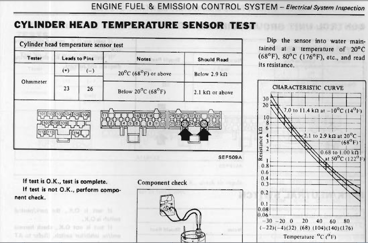

Who did you get the 83 ZXT from? There are a few guys from GA on the 280ZX Drivers Facebook group, one of them I know did the Z31T ecu swap and never got it running quite right.
So, to dig in:
#1: I have attached my zip file of all the important docs and steps for the swap procedure.
#2: Have you yourself verified that the CHTS "reads backwards"?
Ohm sensors can confuse people... the CHTS ohms go down as temp rises, and ohms go up as temp drops (specs from FSM also attached). If the ohms are changing as the temp changes, this isn't the problem.
#3: Verify that you actually have a turbo ecu (CA or FED?), and check your MAF. Does the MAF have a yellow (FED) or blue (CA) sticker?
Check ecu diagnostic codes.
Also make sure the timing is correct (24* BTDC).
