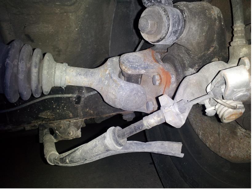

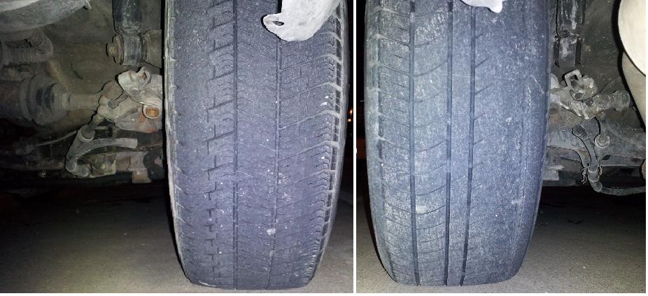

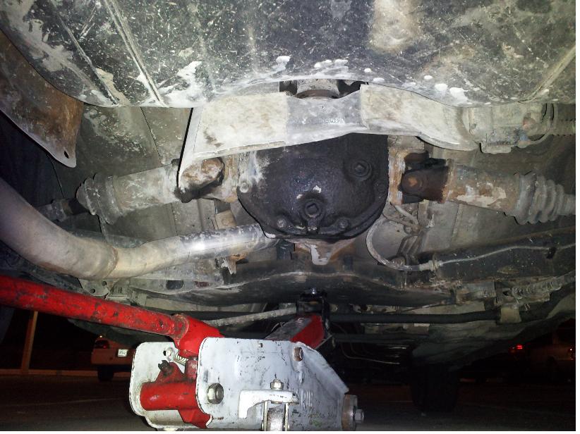

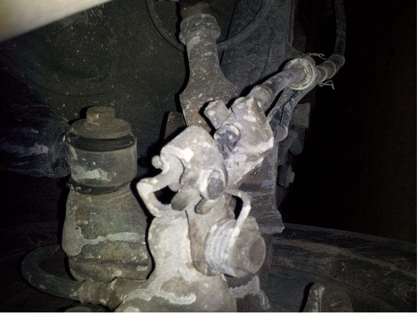

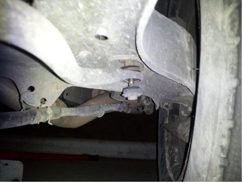

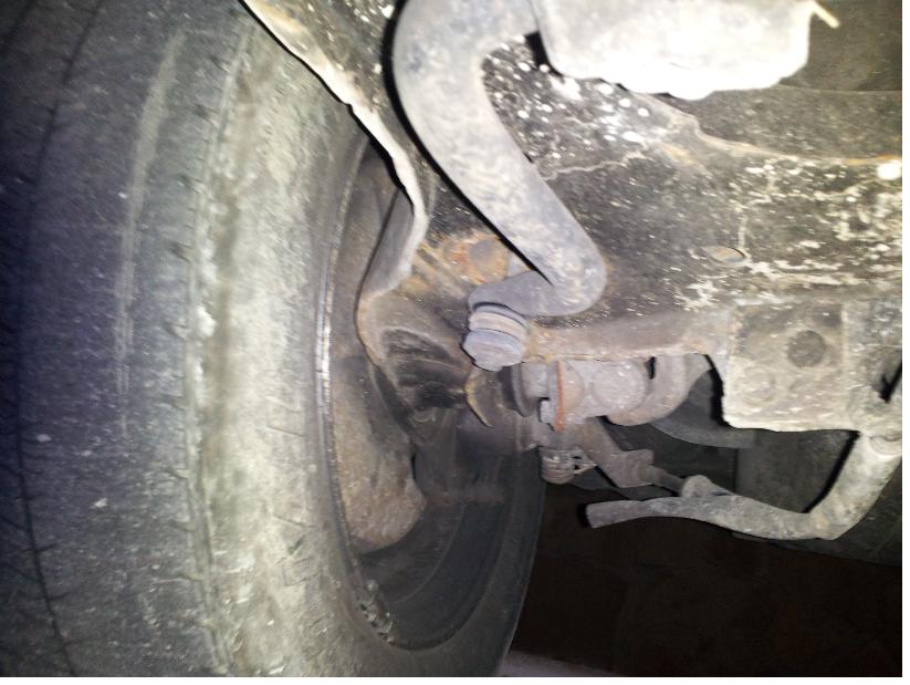

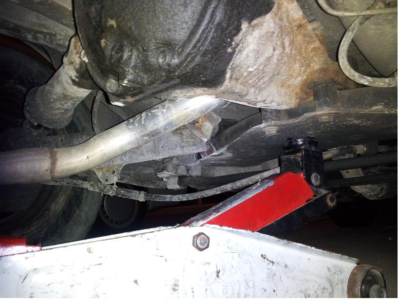

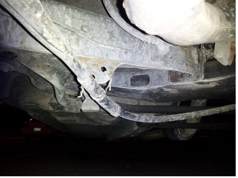

I got underneath it again and got some pics. I put the pics of the back treads next to each other so it would be a little easier to see the difference in wear. On the driver side it's just starting to show a little metal on the heavy wear area.
edit: the second pic needs to be rotated 90 degrees clockwise. my bad.
Attached Thumbnails Wheel Spacers-tires.jpg   Wheel Spacers-2004-12-31-18.03.51.jpg   Wheel Spacers-2004-12-31-18.05.11.jpg   Wheel Spacers-2004-12-31-18.07.50.jpg   Wheel Spacers-2004-12-31-18.13.06.jpg
Wheel Spacers-2004-12-31-18.13.51.jpg   Wheel Spacers-2004-12-31-18.15.44.jpg   Wheel Spacers-2004-12-31-18.18.28.jpg

Old Oct 6, 2011 | 08:38 AM
Which pic is showing the bent cross member?

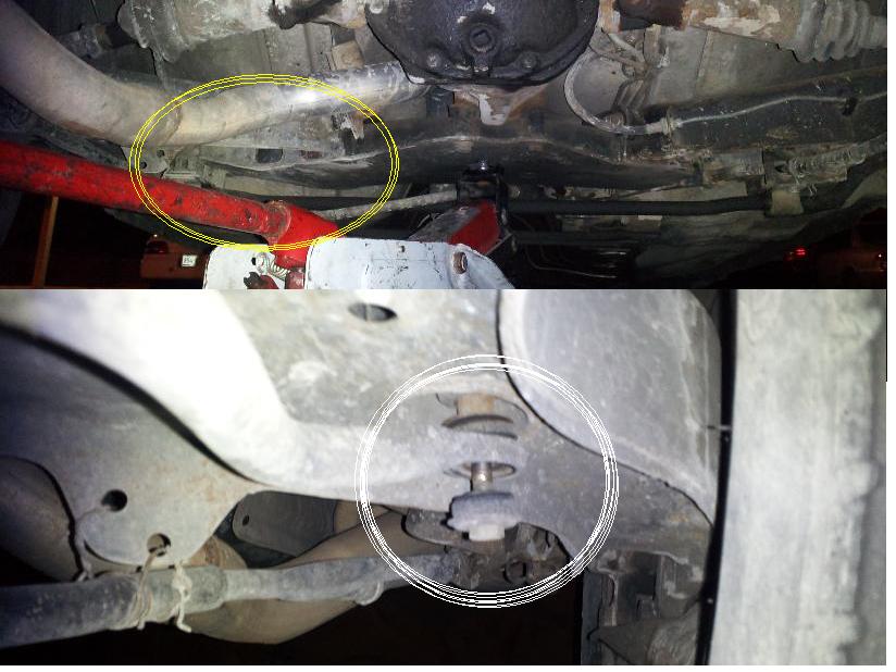

I guess the pics aren't the best angle. I wasn't on flat ground when I took them and was afraid that the car would roll on top of me if I lifted it any higher. I'll get a better angle tomorrow when I have more time. I reattached the pic, circling what I think is the bend in red. The other side doesn't seem to be as bent in the same relative area (which may be the problem). I'm not sure, which is why I included the other pics of the rear suspension and tire wear, hoping they may help pinpoint the problem. I also circled the driver side suspension bushing in white. It just looks like it needs to be replaced.
