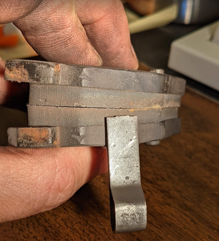

I'm seeing angled brake pad wear as well, as you can see in the photo.
This is off a 1983 280ZX NA, after running 2-3 races in the 24 Hours of Lemons.
Near as I can tell, this is caused by wear on the caliper slide pins and/or bores that the slide pins run through.
With enough wear, the two halves of the caliper can move enough to form an angle between them.
