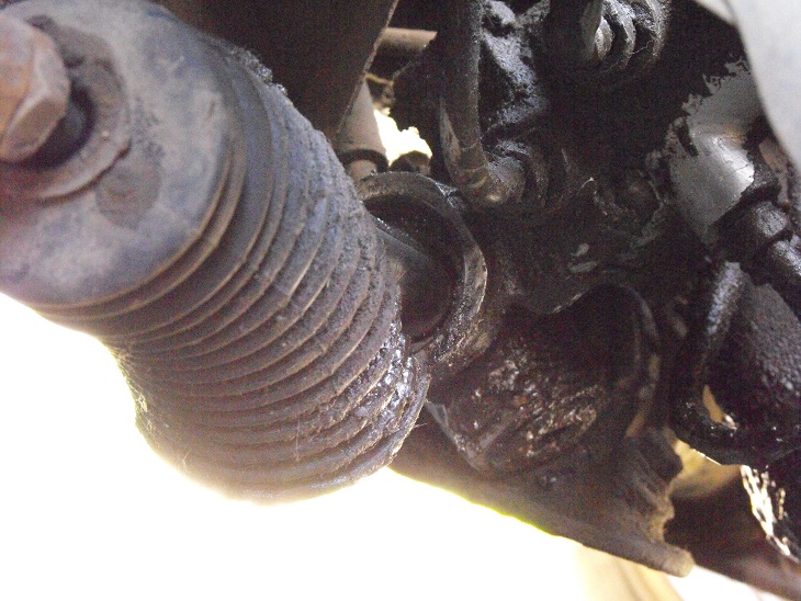

See sig for my car. I got to looking under the hood and noticed that the driver side boot for the power rack and pinion was torn. I know it needs fix, but is this a do now, or do later. I have a lot to do to the car so it would be driven very little, but if this is a imminent problem I will fix ASAP.
On a side note, WIKI made it look like power rack and pinion did not co*me(even as an option) until 82. Is this a mistake on WIKI's side? Is this rack and pinion?
Please see attached pictures to get a better look at torn boot.

i say do it soon, boots are cheap, that should be something easily done by your self
as for the power steering option thing i have seen 79's with rack and pinion, weither or not they were swapped was something else but rack n pinion shoulda been available before 1982

You will find that all the general auto parts stores (Shucks, Kraegon, Napa, Autozone) will have the wrong part listed for the power rack boots. The boot you get will not fit over the inner tie rod end to clamp down.
I tried so hard to get it to fit but never could. I even boiled the rubber in hopes of it stretching more. I finally took it back and checked with other parts stores. They all listed the same part.
Nissan is the only place to get this part and its not nearly as cheap. If you don't replace that part soon, your rack's seals will go out and it'll start leaking badly.

I saw a Power steering line going into the same area the steering shaft went into, but couldn't see enough to say for sure whether it was r/p or r/b.
It should be pretty obvious. The recirculating ball setup mounts on the frame and sets up above it, and is big, cast iron, and ugly. The R/P mounts to the k frame and is aluminum and not particularly obnoxious.
Edit, this is stupid, r/b ball type doesn't have that boot. It's power r/p.

Yes, but, his unit has a pressure line going in, and recirculating ball types don't HAVE that boot, so the only thing it CAN be is a power rack and pinion.

From my research nobody sells an aftermarket part that works. You will need a Nissan brand boot. You can find online sources to buy Nissan brand parts. Courtesy Nissan and Nissanparts.cc are examples. Maybe even Motorsportauto. zcarparts.com
