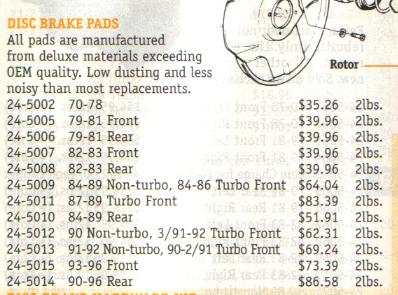

79 - 83 should have the same front strut mounts. There weren't any changes on the fronts.

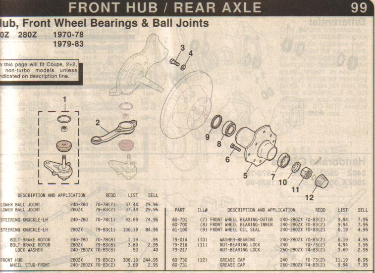

According to both MSA & VB catalogs: 79 - 83 pads & rotors are the same:
Attached Thumbnails Front Brake Calipers-front.jpg   Front Brake Calipers-front2.jpg
