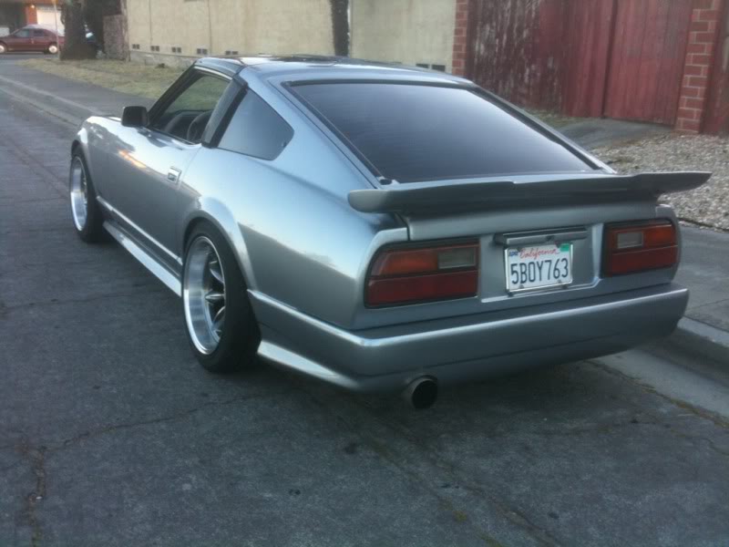

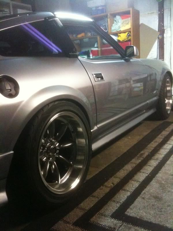

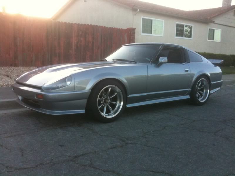

it lowered the car about an inch.. and yes it did stiffen up the ride.. ive been very happy with them.. and i just recently bought another set for my 280ZXT project..
heres some pics of my car and how it sits with my new wheels

Thanks icice9 Ill Go Ahead And Order These For My Z Ohh By The Way What Size Are Your Rims????
Old May 23, 2011 | 09:38 AM
icice9's Avatar
Super Siver & Black Stud
Joined: Apr 2003
Posts: 1,526
From: Hayward Ca
front= 17" x 9" in the front and rear= 17 x 9.5"
Your Z is sick ice, those wheels make it seriously mean!

I've seen Ice's Z in person. It is pretty damn sweet.
