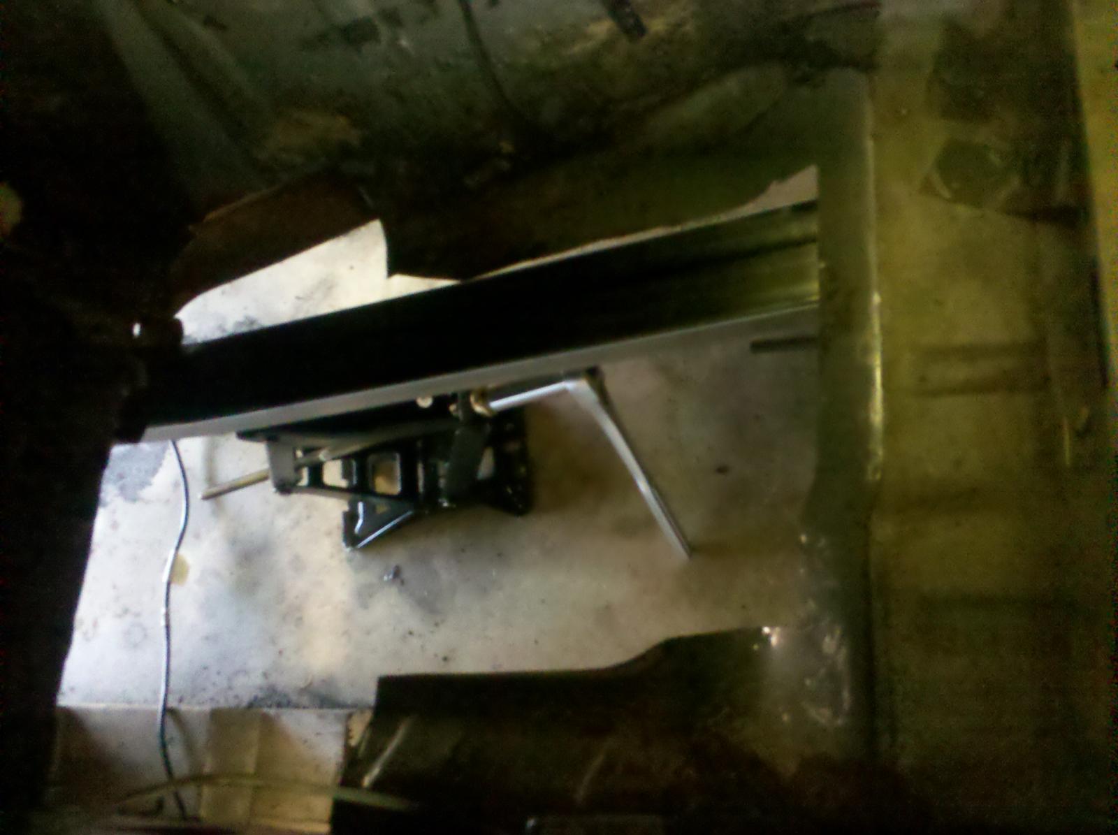

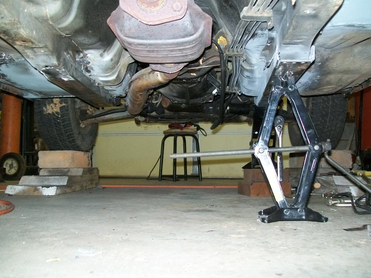

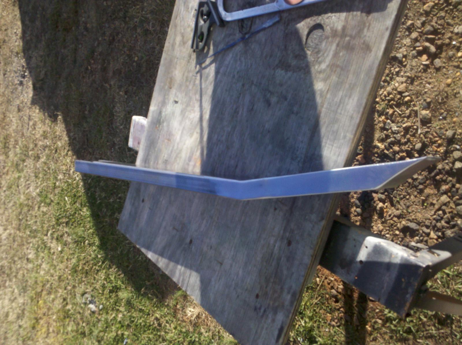

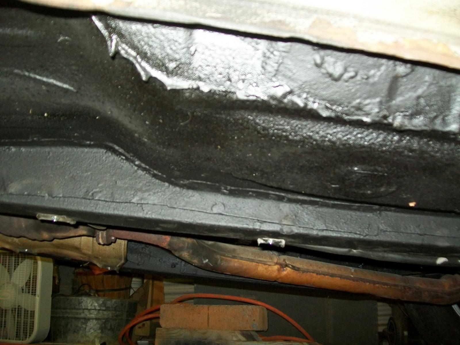

A little late on this.16ga is actually thicker than what was originally there.I just made my self some replacement floor supports as that is all they are from 1.5 X 3.00 mild steel tubing and made 1 x 1 angles to fie them into the floor similar to how the factory had them.Based on the good metal that was left in what I cut out of my 82 the original rail was.041 thick this is 19ga.The floors were .034 or 20ga. I bought just under a half sheet "drop" for like $35.00 and a 20 foot stick of 1.5 X 3 X .072 tubing for $80 I also have an 81 turbo that needs the same work too.This is pretty much enough syuff to fix both cars.I also bought a HF 30 inch brake to bend my angles on.Hope this helps somebody.More pics of my project are here. http://www.facebook.com/media/set/?s...7523353&type=3

If you do not remove any of the rockers and just the rails or the bad part of the rails and floor section you should be fine.I put my car up on ramps in the back and front and added solid concrete blocks under them to get a comfortable height.This kept all of the stress in the proper places.I only did one side at a time.Like it was stated above the strength is in the rockers and tunnel as far as the floor goes.
