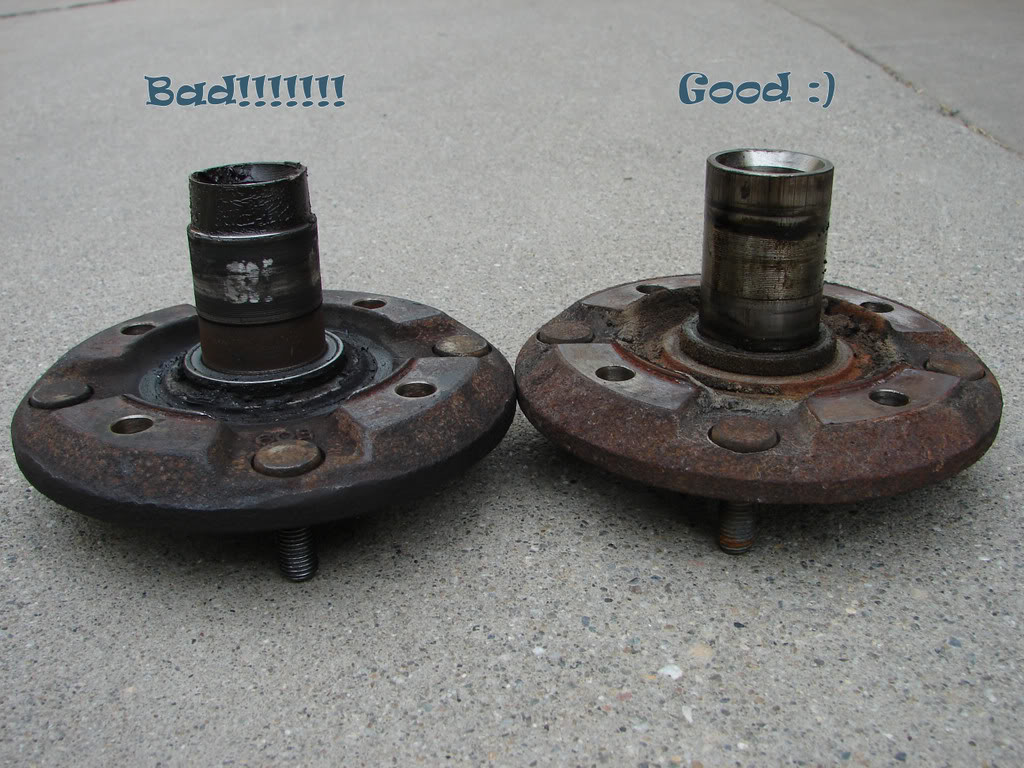

You'd have to check it with a measuring caliper.
And now that I think about it, it's more likely a warn / damaged stub.
I had that happen on my Geo Metro a few years ago... it wobbled when I bought it, and when I yanked it out it was visibly worn:

I'll definitely look into getting a new stub or some how fixing the old cause mine looks pretty worn haha. Thanks for the help! Hopefully I can get this fixed soon!
