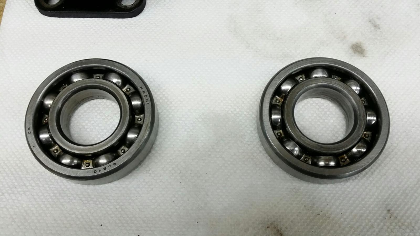

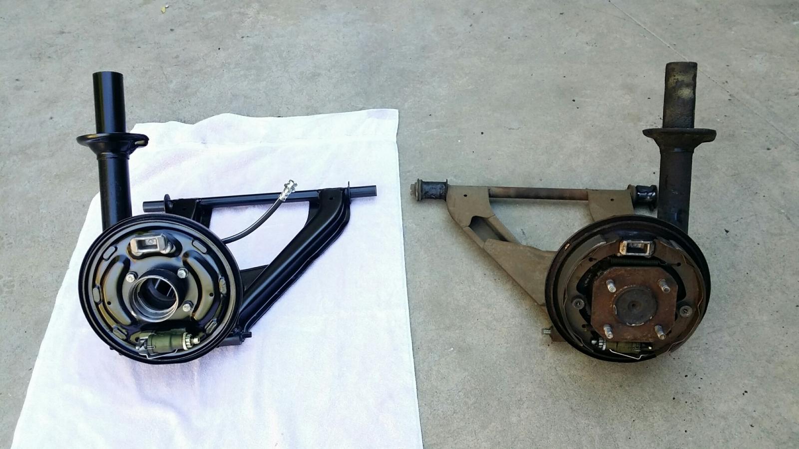

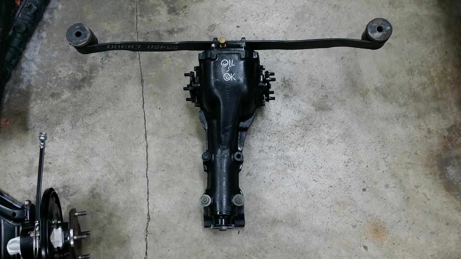

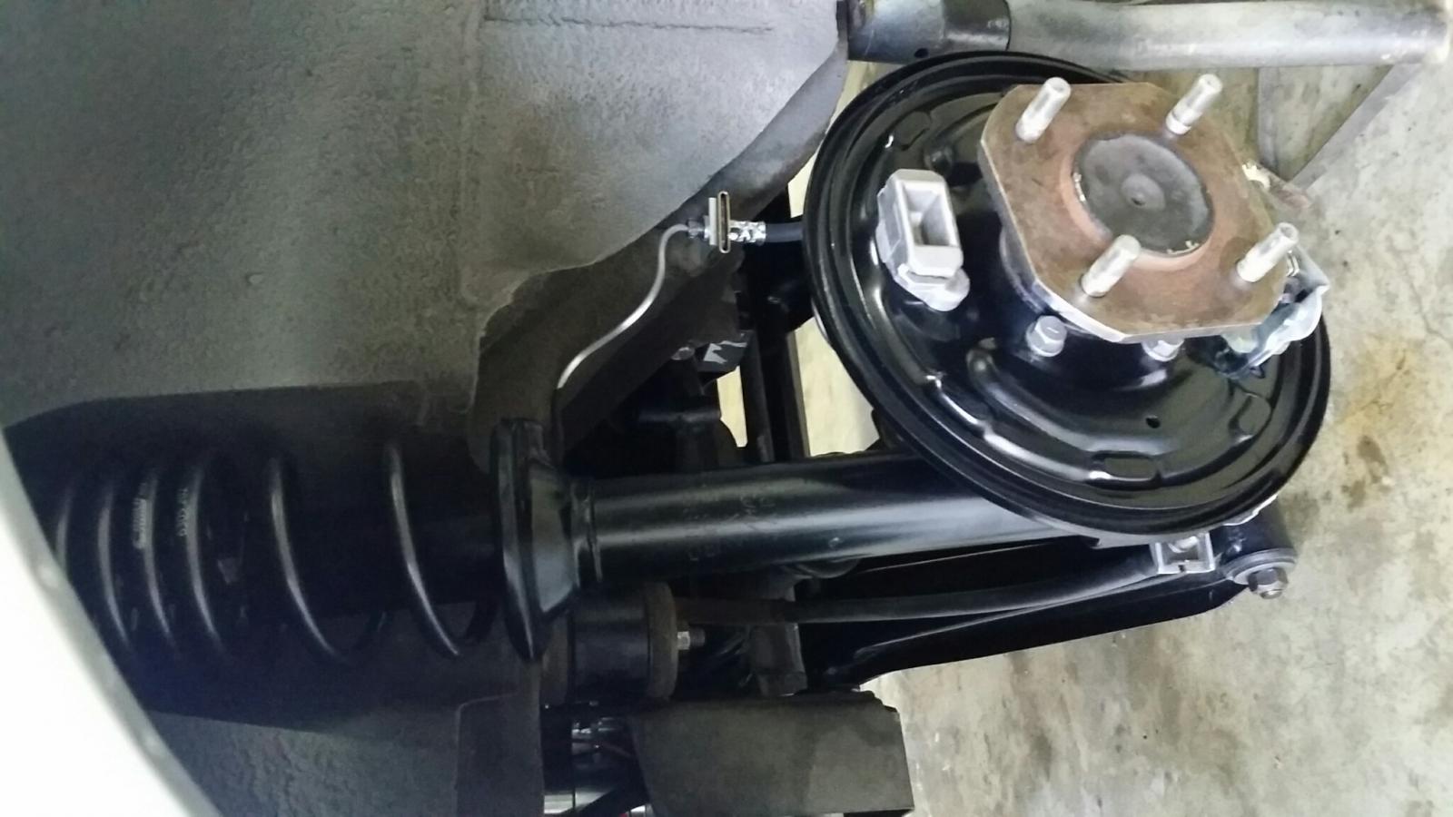

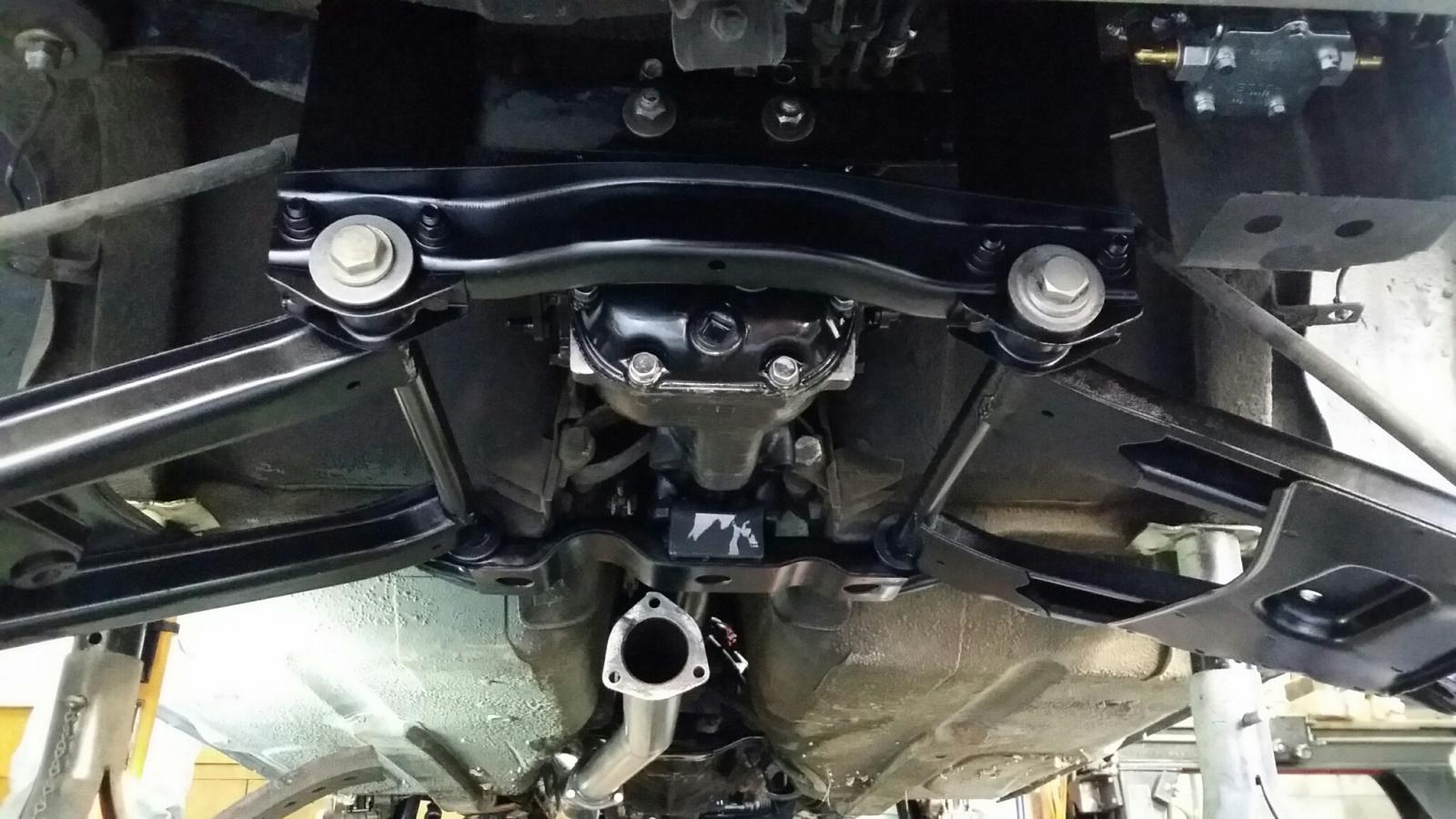

I just restored the entire rear suspension and drivetrain of the car. I cleaned and greased the stock bearings; they seemed perfectly good. I reassembled the rear hubs and tightened the stub axles with new self locking nuts... around 200 ft/lbs.
The question: The axles rotate smoothly, they just seem tight. I come from solid axle cars, and those puppies spin like a top. How tight should the axle be in terms of rotating it by hand? Just seems tight to me.

I have the service manual and the How to Restore Your Datsun Z-Car by Wick Humble. It states to torque the nut between 180-230 ft/lbs... my torque goes to 150 ft/lbs, so I capped it at 150 ft/lbs, then used my long wrench with a pipe and gave it a little extra (in one of my photos above).
I rotated the stub axles after torquing them to 150 ft/lbs to use as a reference. After torquing with the pipe the extra bit, probably to around 200 ft/lbs, they rotated the same as when at 150 ft/lbs... it just seems tight compared to what I am used to... physically rotating the axles.
I greased the bearings and seals, nothing else. The differential was sent out to a professional.
