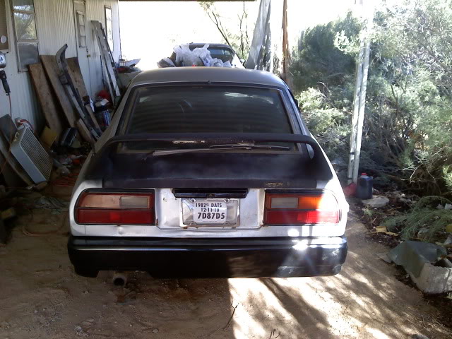

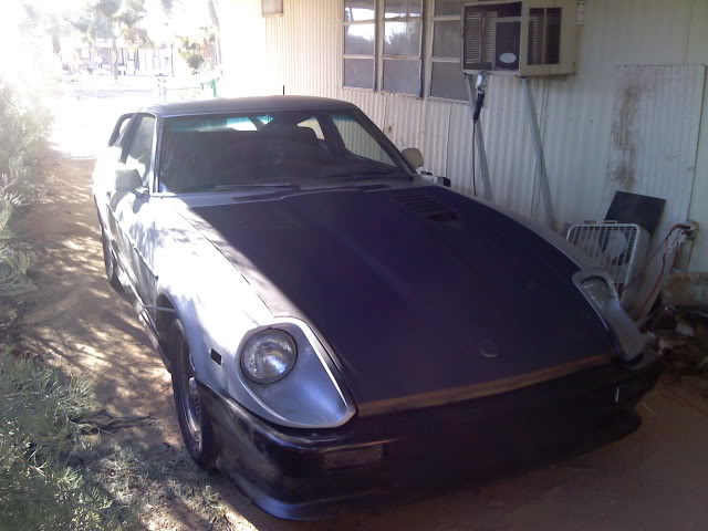

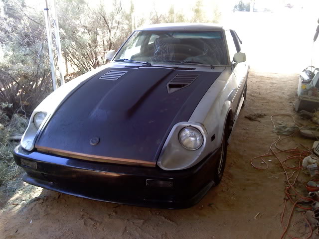

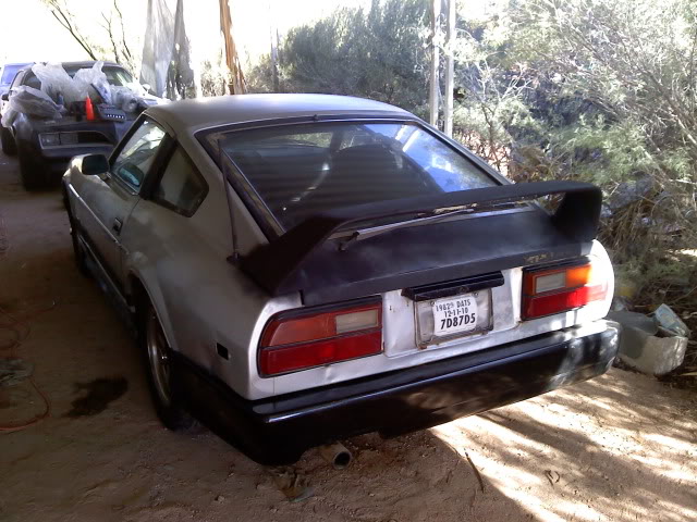

I already starting mocking up my bodykit today. It is on the car, just not permanent yet. I decided I am going to drill the holes. There aren't that many to do. And they are inside the fender wells. Then I thought maybe, I would use the body glue to give them a better hold on the stock bumpers.
More coming soon, I should have it mounted completely tomorrow. And of course..pics will follow.
Old Dec 3, 2010 | 02:28 AM
  #45
Allright..the moment some people have been waiting for. These were taken after I mocked up the bodykit on the car. It got dark, when I finished mounting it. So I will take pics tomorrow, and post. Enjoy, and feel free to comment.

Old Dec 3, 2010 | 12:06 PM
  #46
Like really? Nobody cares what I have been doing? j/k As long as you look at my pictures. It's cool. I will have more in a while.
Old Dec 3, 2010 | 12:52 PM
  #47
looks better. Those sprayed? or just ridiculously shiny urethane?
Old Dec 3, 2010 | 01:02 PM
  #48
evandubya's Avatar
Primer Grey FTW!
Joined: Jul 2010
Posts: 587
From: hawthorne, nv
Looks great!!! Now you need to update the pics on your signature.
Old Dec 3, 2010 | 01:12 PM
  #49
Thanks man. Yeah the person I got the kit from, painted the kit gloss black. It has quite a few coats on it. So I believe it was painted professionally. It has a few chips and cracks in it. But it still cleans up pretty nice.
Old Dec 3, 2010 | 01:14 PM
  #50
Thanks man. Oh I will, as soon as I take pics with it mounted on the car. Will do that here in a bit. Stay tuned.
