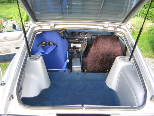

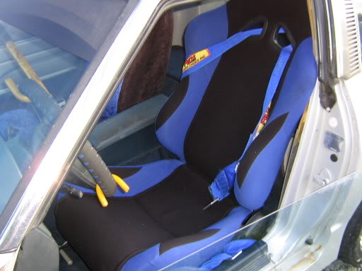

yup mount to the strut towers and the seat belt outer mount and either drill and reinforce a mount or use the lower seat mount that is reinforced already.

Yes that is correct. Mine are level which is still acceptable. I'm also going to revise this design once my thumb is finished therapy. I'm building a strut tower brace that has belt mounts that are straighter with the seat. Gotta build it really strong to support the load tho

Level or higher is preferred. If it's slightly down no biggie. It's if the belt go down quite a bit that it is the problem. Mine are almost level the way my seats are. Maybe a degree or two down. I also mounted the seats to the stock mounts minus the sliders. I sit quite low in the car even tho I'm 6 foot

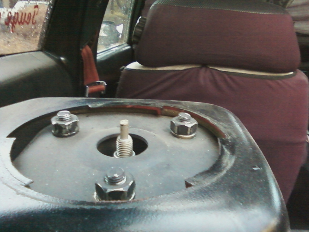

My concern is the bolt shearing in a bad front/rear crash or getting rear ended and having the strut tower bend forward/down and loosening up/crushing you.
Old Oct 24, 2011 | 07:21 AM
yeah thats why im building the strut bar, 3 bolts and thick steel and a good sized tube to give more support. this is better than my stock belts tho that stopped locking and allowed movement when i gave them a quick pull (failed autox inspection). i tried rebuilding them, but nothing looked wrong, just wouldnt work correctly, so i switched to 4 pt. belts.
