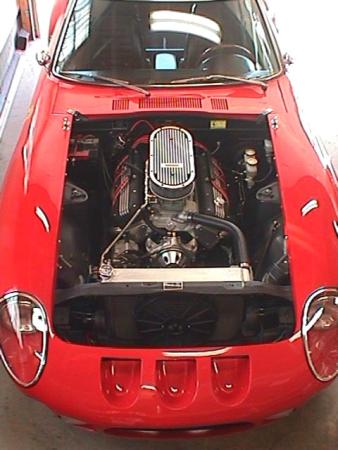

GM Crate Motor
GM crate motors are pretty reasonably priced, come with a warranty and they sell some 383's.
Do you know if the conversion on your 240Z was done using the Jags That Run (JTR) method or something else? You might want to get a copy of the Jags That Run conversion manual. JTR Datsun Z Car V-8 Conversion, manual for Datsun V8
Also, you might want to check out the HybridZ site. HybridZ
Good luck.
http://www.cardomain.com/ride/236622...rrari-250-gto/
Attached Thumbnails V8 Choices for 240Z-ferrari_38.jpg   V8 Choices for 240Z-photo8.jpg
