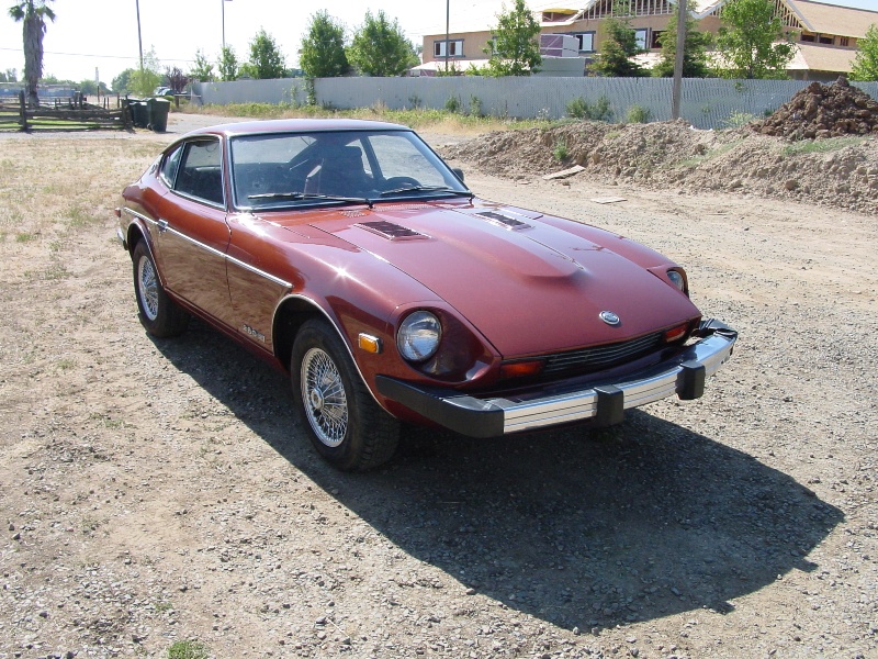

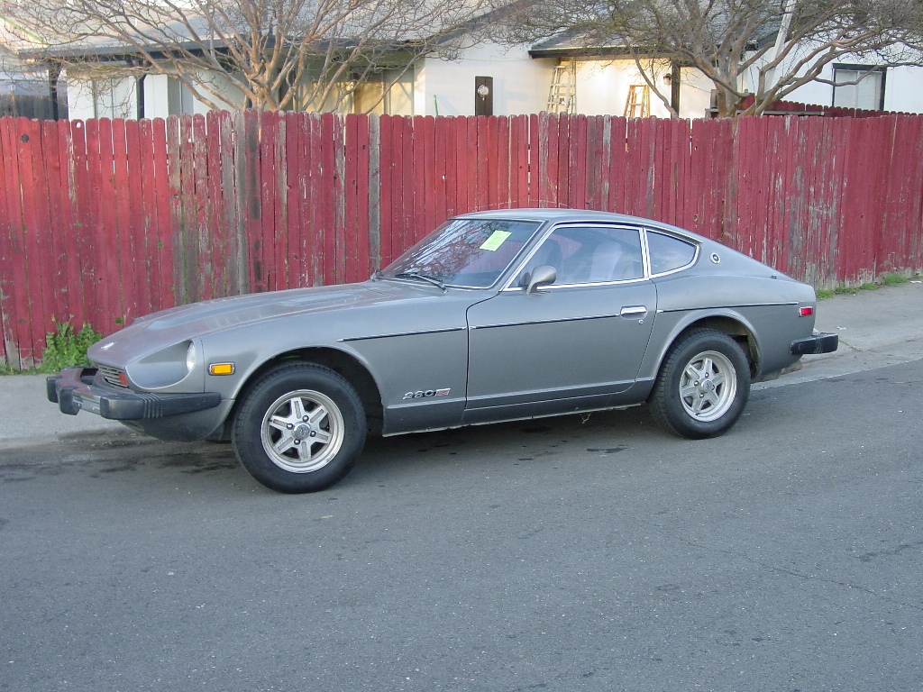

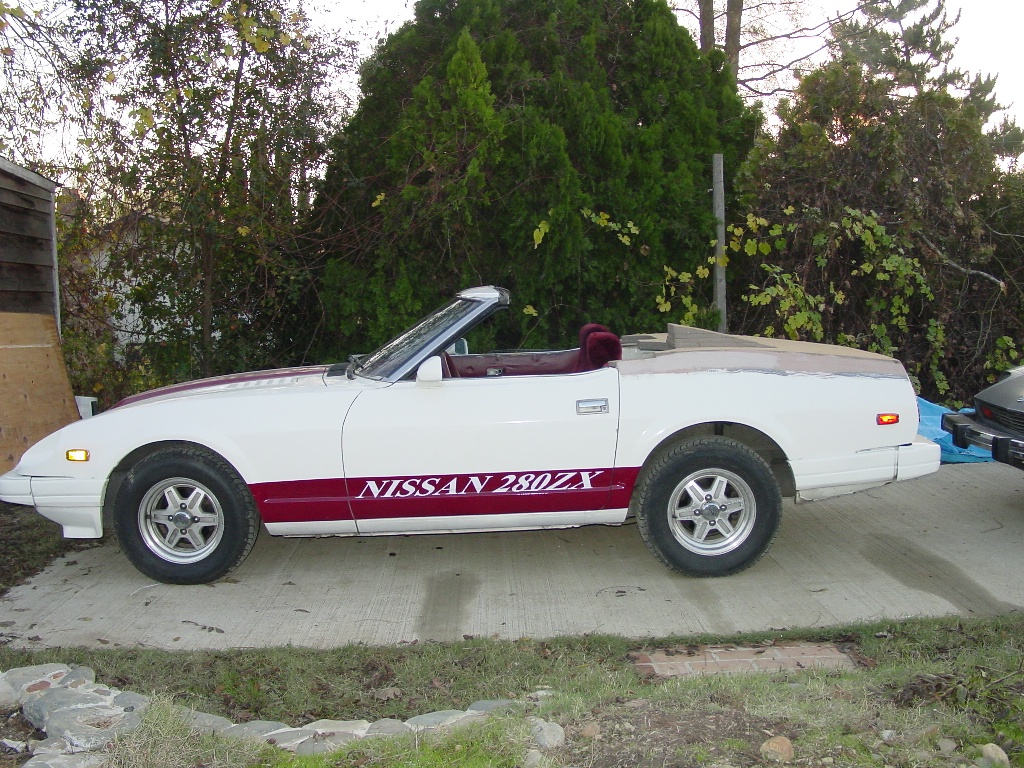

I have attached 3 pics of 280's I have owned. I like to bless people. I gave the gold 280z away to a friend and I gave the white ZX to my nephew. The silver/gray Z is the one I presently own and am restoring.
