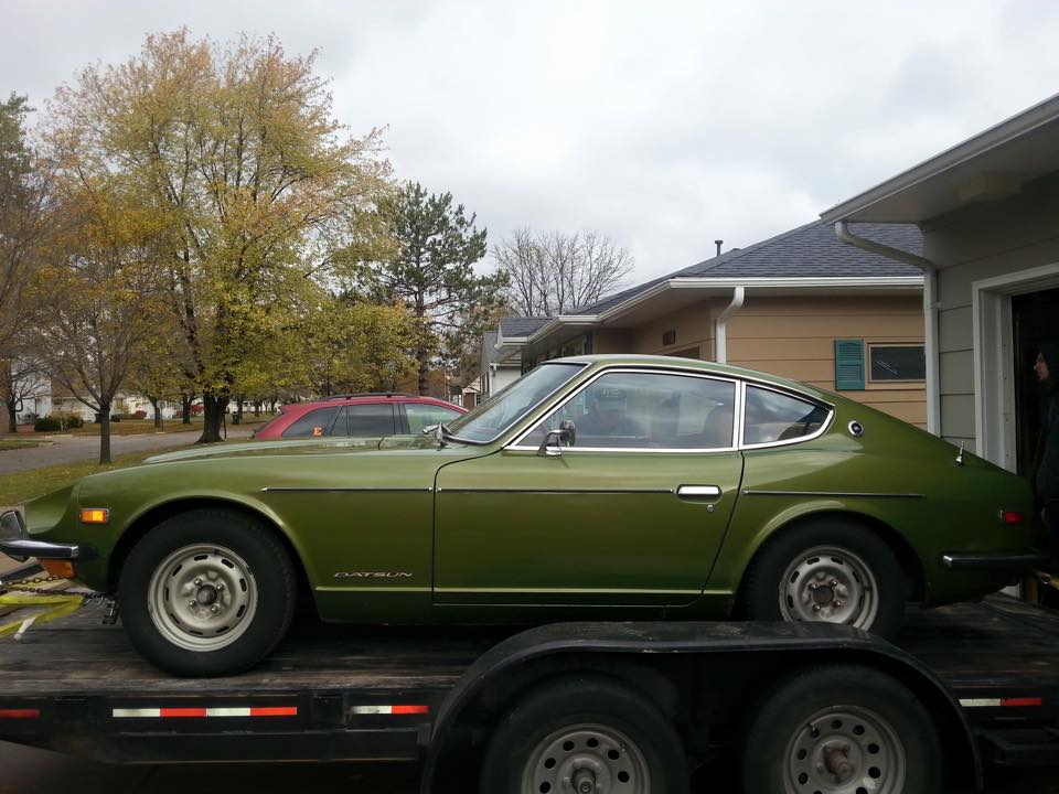

Hey guys! This is my first post here, I just finally convinced my grandfather to let me rescue his 1973 Datsun 240z.

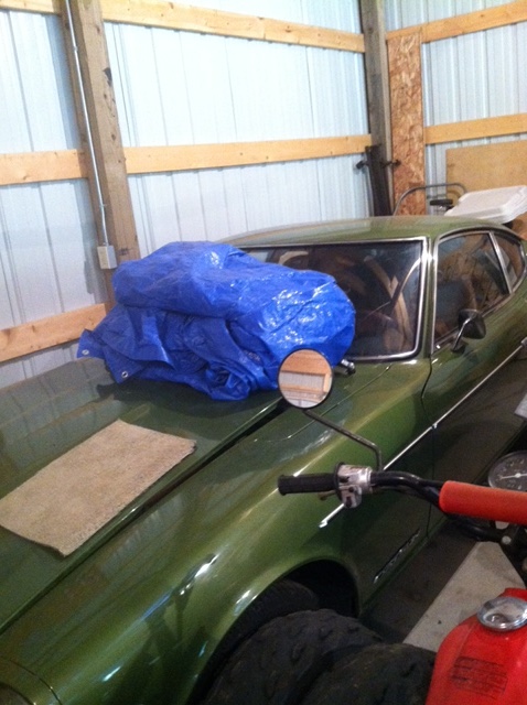

He was the original owner and bought the car brand new from a Datsun store in upper Michigan. The vehicle right now has just over 82k on it, however for the last 10-15 years the car has been sitting in his pull barn covered up without being driven.

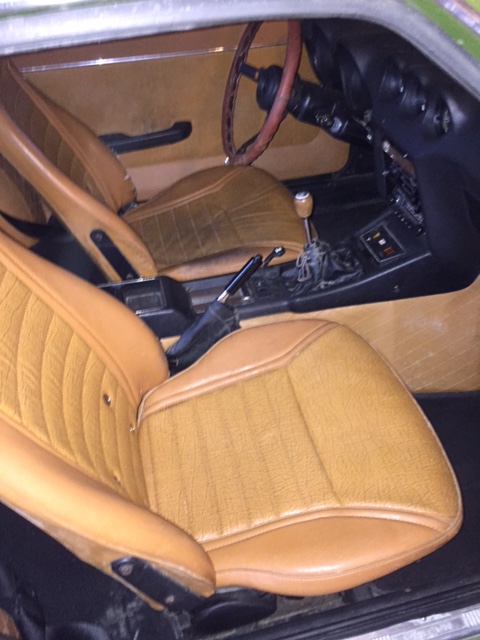

The body of the car is in great shape, the interior is still in pretty good shape especially considering the year, however the brakes are completely shot. Also the stock clutch is stuck to the ground.
I currently have a 1992 300zx TT that I have been working on and modifying for over 5 years and have always had some type of project car whether is was my fathers 66 chevelle ss or my first 1999 Honda civic si. so I like to believe that I can do most of the work myself as I have always been pretty mechanically inclined.
The reason I am in this forum is because a forum has always been the best way for me to learn about a specific car. so I figured this was the best place to start.
really I just want to know what you guys think about how the car looks and from my description how much work you guys think its going to take to get the car back to driving condition. my grandfather said that when he sprayed some oil in the carbs he was able to get the engine to turn over but the brakes and clutch have kept it from being driven.
Also any typical things to keep on the lookout for with the s30 as well as the best place to source parts would be appreciated.
I am located in the central New Jersey Area so if there are any shops or members with expertise in the area let me know bc I plan to bring the car back to life and I know it will be a long process with lots of questions.
here are a few pics to give you an idea of the condition. the last picture was how it sat for over 10 years

nice. My grandpa could have left me his Model A but died before I could plead for it. Any way just put in new clutch hydraulics and new brake master cylinder. wheel cylinders could be okay but if no workee change them also. if the clutch plate is welded to the flywheel you might have to drop the tranny (needs new fluid anyway.) the S30 is pretty basic mechanically and electrically
rogerz is on the money. You need to thank your gramps over and over again.
The only scary thing is this is a Michigan car. My parts car is from Michigan and it's a basket case, even Fred Flinstone wouldn't drive it. That said, it looks from your photos that this car might have been a Summer car and stored in the Winter. Do check thoroughly for rust cancer as these cars are mighty prone to this disease. I see you're in New Jersey so you probably have experience with this as well. Rockers, floor pans, dog legs, rear quarters and so on should be checked. Since Gramps is the only owner so far, you've got a great resource for history.
Get yourself the factory service manual for this model year. "xenons30.com" has them on their web-site. Read that manual over and over. It's chock full of information. Sometimes it is a little difficult to understand but most of what you need to know is in there. The rest you can search the Z car forums (this and several others) for info. Most likely someone else has already asked your question. If not, ask away. Folks here are ready to help those who have done their homework and are stuck.
When you do ask a question, be specific. Tell us what you've already done and of course the year and configuration of your car. Sounds like you've got skills and tools so have at it.

Beautiful car. If it was mine, I would restore it to original. I love modifying things, but this would not get touched, especially if it was in the family. I would say, get it cleaned up, check for rust and corrosion in usual spots. Keep it running good, and keep it like it is. Good luck and have fun, that is a gem.
I would leave it stock since it is worth more that way. Find the correct hub caps if you don't already have them. Matching #s, original owner/paint, little to no rust, low miles, easy $10k. Stock cars are boring so if you must just do suspension, bushings, the usual tune and repairs. Save the old wheels and hubcaps.
