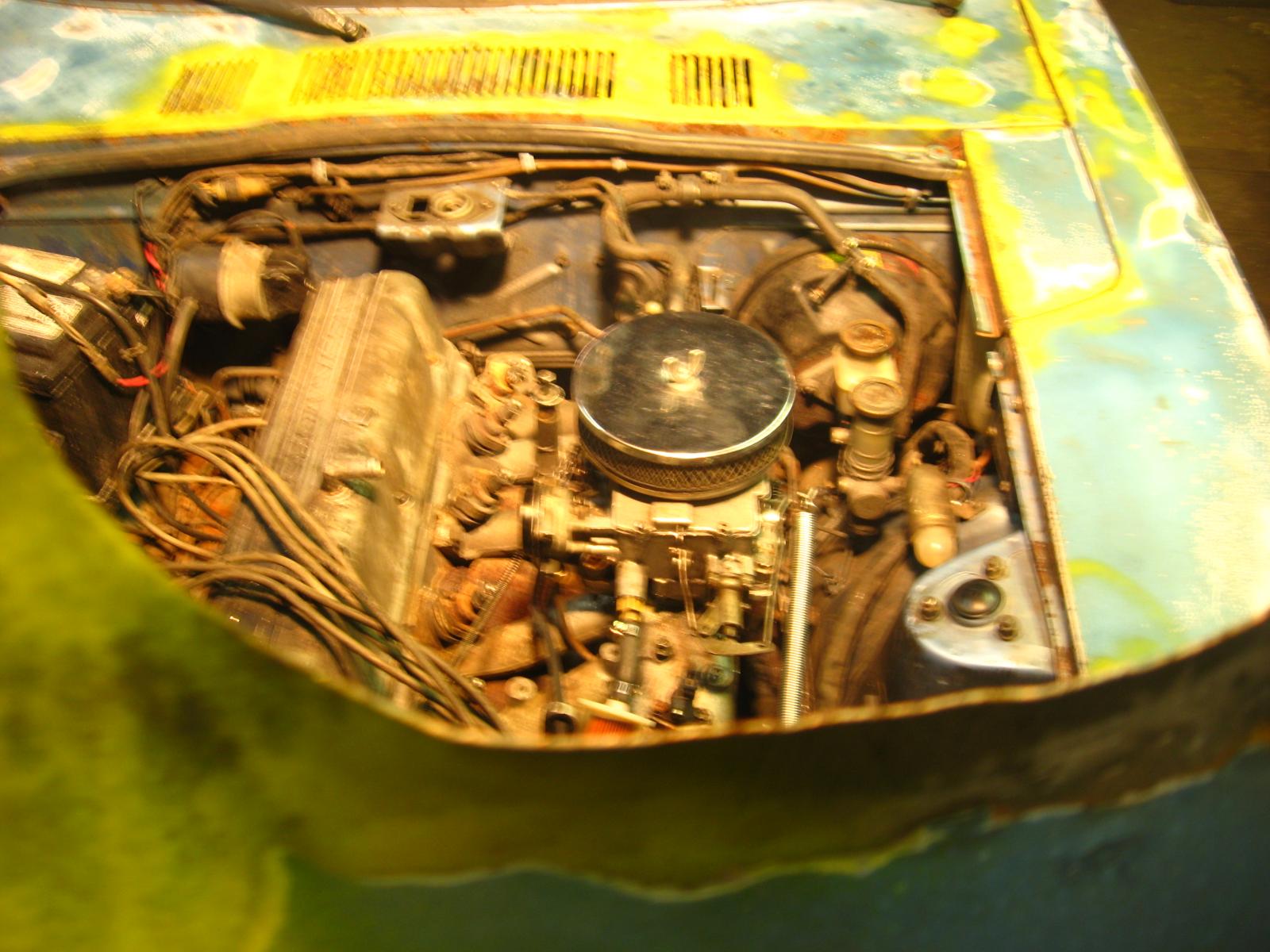

4 Barrel 280z
I've done it and it's easy... I even used the original plenum, just cut a hole in the top and built my own adapter. The fuel pump can be used, just use the return line to take the pressure off. Put a crimp in the return line if you need more pressure, no problem. The whole of the FI elec wiring can be trashed w/o issue. I agree w/ the thought of the "kick" from the secondary cause it is very cool and your z will take off. Here is a pic of the install. cool... ckya dj
