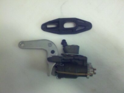

OK gona pick it up
Going out tomorrow to get her and bring her home, and I hate to tow a vehicle home Id much rather drive her home so I’ve got it set up to go out and work on her a little before doing so just wanted to check with you guys since I haven’t had the pleasure of working on the S30’s till now. If the parts house has indeed given me the correct part needed to get the breaks going. So I asked for the right rear wheel cylinder and this is what they gave me. Is it right?? Thanks guys. Will post pics once I get her home and cleaned up.

Don't know much about those parts. But congrats on purchasing the 280z! Looking forward to the pics, when you get it home. Awesome man!

That is a wheel cylinder, but I don't know if its the correct one. Sorry not much help on my part.

Lmao YUP ur right it is a wheel cylinder hehehe.. It is cool thanks.. I’m lucky the guy saved it for me I was suppose to go out and get it the begging of this week but I blew a lil too much money when I went out for my BDay last weekend and had to wait for my pay check. lol

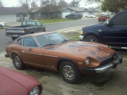

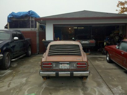

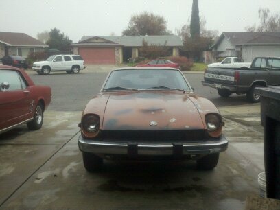

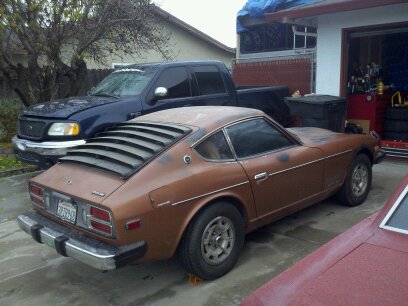

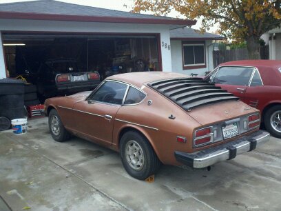

Pic's
Ok guys here they are

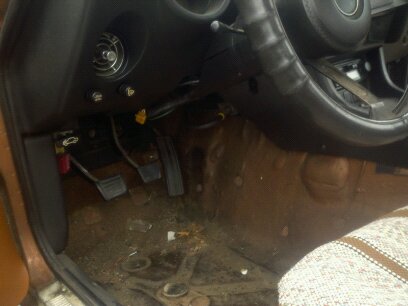

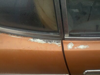

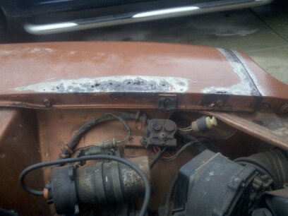

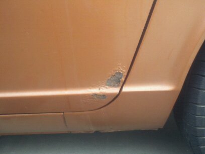

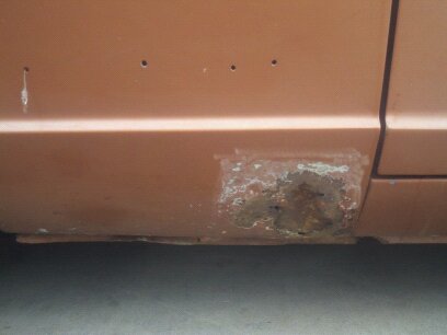

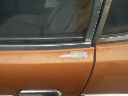

pics cancer
Heres the shots pf the rot going on.. one place thats pretty bad Ill prolly just replace that frnt driver fender it be best.

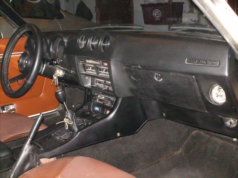

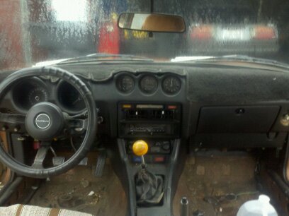

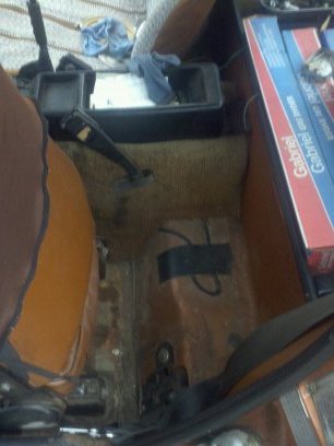

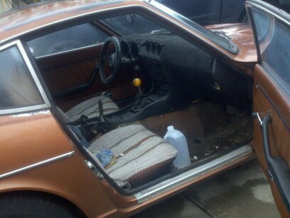

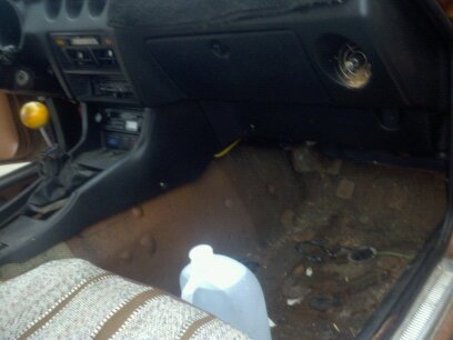

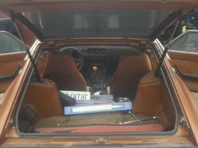

inside
yea so I lied about the black interior. Did they come stock with the black dash set up or has one of the po's allready started the black swap in??

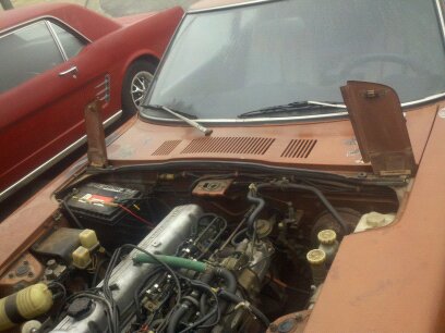

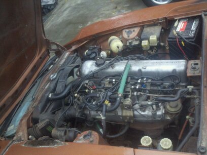

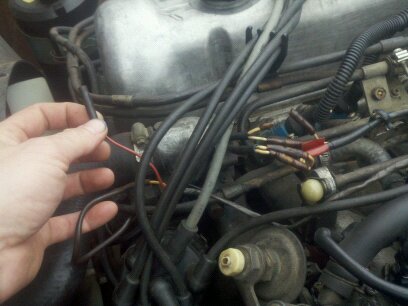

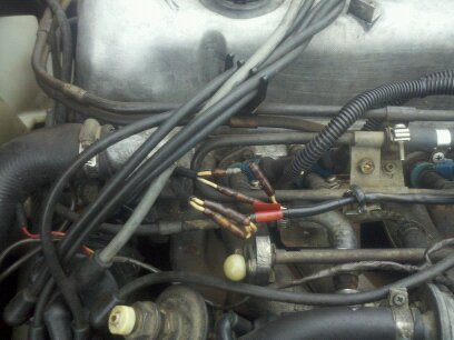

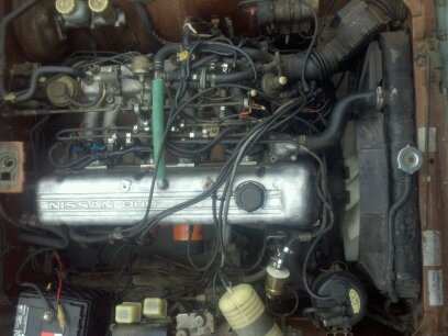

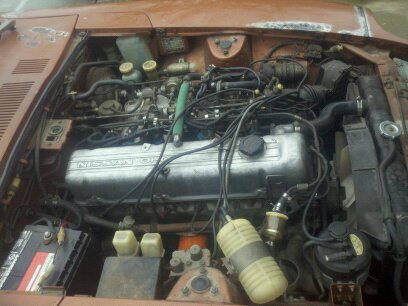

engine bay
a few pics in question here ull see the ones im talkin out havent down loaded the fsm yet but if you guys could clue me in thatd be great!! digin the garden hose right lmao not my handy wrk but its all good..

Thats all the pics so far.
Ok thats all of em. no I haven cleaned it her out yet. notice the four shocks still in there boxes and also the Snap-On fender covers come up!! woot woot lol. So Im gona go out and get her cleaned out, think Ima swap the zx rims on there my tires are better, and Im not digin the stock steelies and hub caps..Um whats the best way to pop off the emblems??? gona take them all off as well as the crome side molding gota get the zx down and im going to sand up those cancer spot hit em with rust bullit and do the primer black paint job thatll do for the exterior for now. have a lot of things to wrk on and parts to get..yeaaaa Im happy about this buy for sure!!! Comments, thoughts, suggestions ????? later guys
Old Dec 11, 2010 | 02:19 PM
Wow, it's in pretty good shape. Is that a Mustang I see in the background? heh heh Looks like you have a few projects going on. Same as me. lol
Hey if you need extra hubcaps like those. I have a couple. I was wondering which Z they came off of. I have had them for years. They are in pretty good shape.
The interior, looks like it was a saddle or brownish color. And it does look like they were converting the interior to black. Looks good, a fun project.

Yea over all she’s in good shape… got a few issue’s known at the moment and I’m sure more will come up. The oil pressure gauge is set up to an after market external gauge, volt meter isn’t functioning, Speedo needle is gone, as well as the light doesn’t work inside the Speedo, need to put those shocks on, re-bleed the brakes since I just got them good enough at the guys house. Needs rear end mounts prolly just do all of them front to back. Ignition switch is broken holding in there but almost had it. Heater core is bypassed. Umm Im sure there’s more but that’s all I got locked in my head.
Yea that’s a “66” stang it’s my dads toy but I do all the work to it great car to drive I love muscle cars too she’s just about done. The interior is show quality even got the factory choice a/c in there. Except the carpet is sun bleached I have to either re-dye it so it’s all original or get a kit. Built 289 under the hood with a holly four barrel she’s a cold blooded bastard but show me a old skl rod that fires right up when its 30 degree's out, without a block heater in it lol. Full dual exhaust. I have to get the a/c comp installed buy new line's and stuff but she’s a DD watch the Speedo go up and the fuel gauge go down lmao.. He has a 91 Chevy too.

The interior dose look like a saddle color not a crap brown ill finish off black when I go to restore her... Ok Im done typing feel like Im writing books on here lately lol

jeeeesus, you post to much haha. I'm trying to catch up! but no the dash and center counsel and carpets are ALWAYS black in the S30's. though they can have that butter scotch interior, which in my opinion, is a nice change of things and looks very nice when re-done. I hate to say it, but if you have rust like that on the fenders, you WILL find much much more hidden rust. possibly in the hatch sills, the floor pans or frame rails towards the front where they meet into the core supports. also check the rear "secrete" compartments. they rust out easily to. Doesn't mean it'll be a wreck, but you'll have some welding and patch work to do. And you won't ever know it until you pull the interior and start searching.
The motors themselves on these cars are stout, but the electrical systems kind blow, The AFM's are prone to problems.
since the car sat for 8 years, did you change the engine oil and gas before driving? i sure hope so if not, do it now, and change the fuel filter. Also do the wires plugs cap and rotor, they corrode and rust. sometimes even the battery cables get crappy on these cars and cuases them to run bad. Beyond that stuff, it more than likely will just need alot of body work and some minor suspension stuff to tighten things up a bit.
also, since you blew one hose already on the intake manifold none the less, i'll bet ya the hose clamps on this car and hoses are original and need changing. all of them. there isn't that many so no worries. but they are made out of a crap material that swells over the time and then just pops.

the last two pics of the crappy lookin wires, all those are for temp sensors. not a huge deal. At least from what I can tell in the pics.

Yea I have been posting a lot lately lol. Ok cool so the dash and consol are probably stock then that’s good news. The carpet has been cut out, but from what’s left looks like it was brown. Haven’t seen sun bleaching reach up to pedal clusters before?? I agree the “saddle” Look's good I like it too. Is that the true name for this color scem?? The seats are jacked but the headliner, as well as around the strut supports the compartments and the rest of the trim are really good only one nick in the headliner. It will all stay till I go to restore it then I will go all black.
On the rust a lot of it looks like stuff (leaves ECT) sat on it and wasted away cuz most of it looks like surface rust. I did see a lil bit of bubbling at the base of the hatch all the rest looks good. I do have some on the pass floor board drivers is mmmmok just a lil there. I have it up in the air now the rails looked ok I will check out the rest that you said to look for but I’m not going to be gutting it out as of yet. My goal is to have the s30 for my DD while I bring back the zx then ill restore this beauty.
The engine did feel strong driving home although I was just cruising didn’t wana get on her especially with the issues I had. I haven’t done the pulling of plug wires to make sure she’s running on all six. I want to clean out the afm just to be sure it is clean as well… Best way to clean it??? The gas tank was completely empty I added 5 gals of fresh 89 for the ride home. Engine oil looks fresh and oil filter looks bran new cap is new as well. I am going to do a full tune up any way I like to run full syn in all my cars. This thing didn’t even have battery connecters on it just bare wire's bolted to the bat I cleaned the wires and put connectors on with an optimum bat I already had. Need to check and clean the cables on the other side.
I will be changing out all the manifold hoses and any others that dnt look that great.
Thanks for all the info… on those crappy wires the one that is disconnected outa the three round connectors. If I plug that in she won’t start, and shell die if I plug it in while running. As to the red wire... I found what looks to be a temp sensor next to the thermostat housing but it’s a black wire black to red usually not smart but idk. The temp gauge is working...
