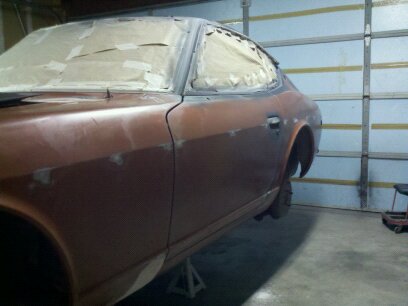

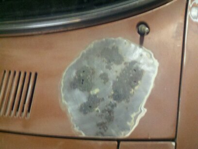

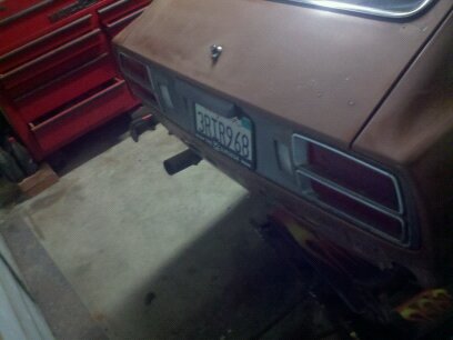

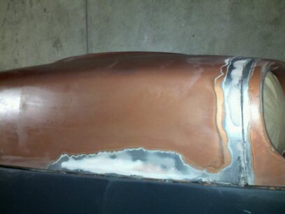

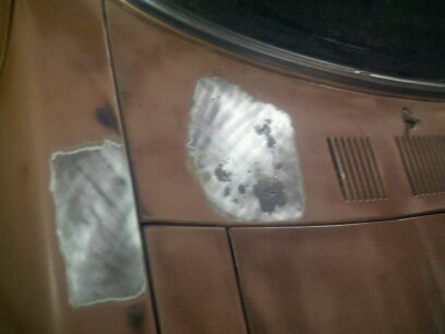

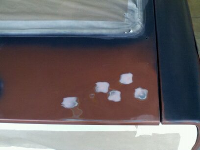

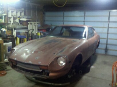

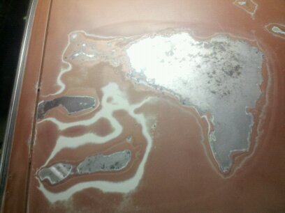

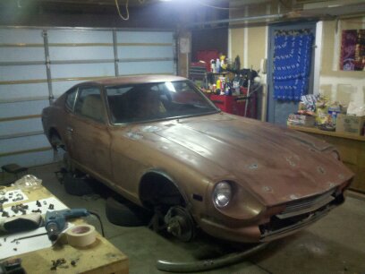

Here are some more pics I’ve got the majority of the rust kicked off. Bumpers off and clear coat broke so my primer will stick well. Ive still got some wrk to do on the roof but, I'm hoping on doing up the bondo today. I’m going to build some custom bumpers, and not put back on the 2 tons worth of stock bumpers. Mine wont protect me in a wreak but if they turn out as good as they are in my head they should look pretty cool. Ill get a pic of what im thinking about soon... thanks for the comments and keep em coming. Enjoy

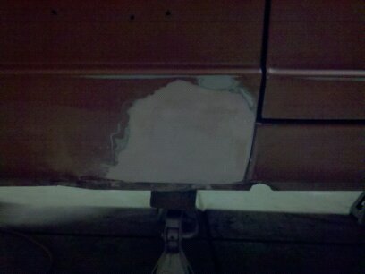

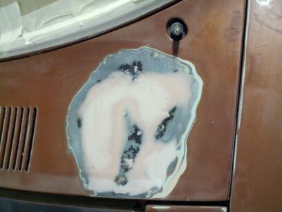

Bondo'ed and primered

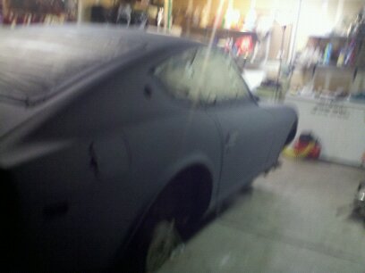

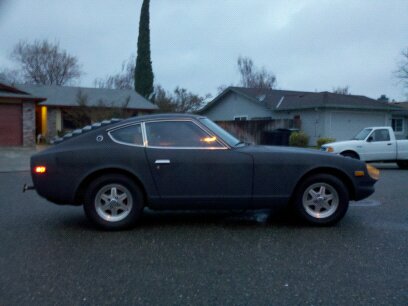

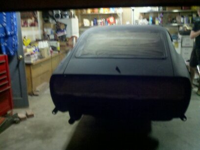

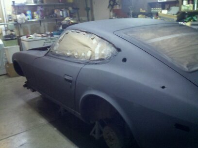

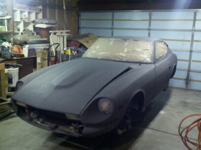

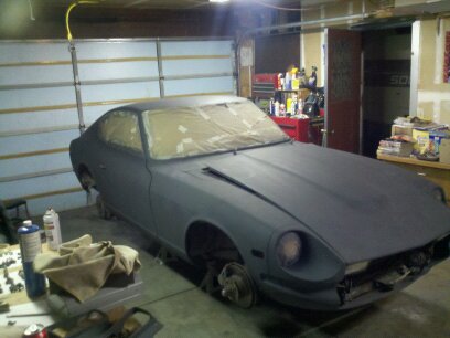

OK guys!!!! Got er done… at least the first coat still will have to do some touch ups and feather the paint off of the bondo spots got those typical grey patches where the bondo is, as well as do the inside hatch and door frames ect. Over all she looks good. I am fighting myself really hrd on not hurrying this process, as is the point is to save her from rusting out any further and to look good, while I take care of the zx. I can’t wait to put the wheels back on her and pull off the tape to get a real look at her completed. Then it’s into the mechanical end of things to get her legal and on the road then I will further the upgrades as I go. Well here’s the pic’s

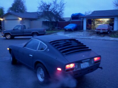

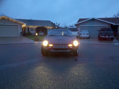

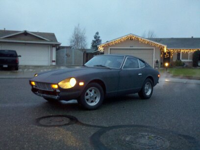

finnished
The primer needs to cure the rest of the way but her she is. cant wai to get it tuned up and road worthy

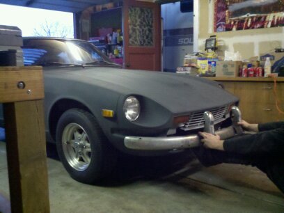

Lat ones my idea for the custom bumpers
