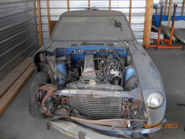

There are three pictures here from an add on craigslist. The owner claims that the transmission is good and the motor runs, but that the car needs wheels/tires and exterior/interior work before it's a good car. He's only asking $700 for it and it's not too far away from me (in Iowa). Does this look like a good buy? If I go check out this car, what sort of things should I look for?

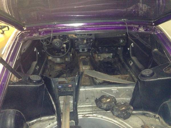

Another choice for me would be to buy a 260z shell that someone has for sale at $900, then buy a wrecked '76 280z with motor and transmission intact for $500, and do some magic till I have a working car. I don't know if the L28e engine is compatible with the 260z, but I assume one of you would know.
The shell would be about 5 hours away from me, but the engine is in my town. This is not my first option because it costs more than the other option and seems to be a bit more work involved.
Attached Thumbnails First Datsun Buy ('75 280z or 260z)-shell-1.jpg   First Datsun Buy ('75 280z or 260z)-shell-2.jpg   First Datsun Buy ('75 280z or 260z)-motor-1.jpg   First Datsun Buy ('75 280z or 260z)-motor-2.jpg

That's what I've heard. So I should try to go down and see the body on these cars before I actually buy anything? Honestly, I think that first one looks like the body would be pretty bad. If I went against my better judgement and bought this relative heap, how much should I be expecting to pay for new wheels/tires?

Yes, you definitely need to go look at the cars in person. Just because the body looks good in the pics doesn't mean there aren't any hidden rust issues. Be sure to check the frame rails underneath, and also check the floor boards. The battery tray and also under the rear hatch are some other common problem areas for rust. Proceed with caution!

Door jams, under wheel wells, runner rails, around windshield, and rear quarters are troublesome too since these cars are unibody so any repair will involve cutting and welding.
