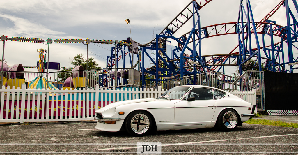

Here a couple of quick pictures from a car show in the local area a couple of days ago.
