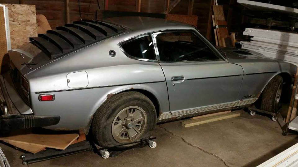

I attached a pic of the car pretty good little barn find should be pretty nice when its done
