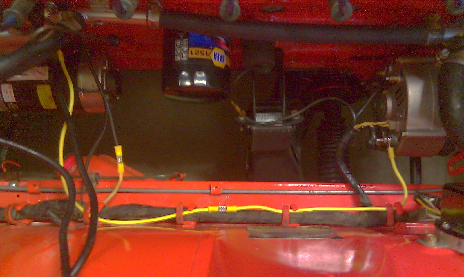

I was working on it over the weekend. and finally got the electrical to work. For some reason. I used a multimeter to check out all of the electrical. All of the grounds are GOOD. The thing is It is temporary, I Hot wired a electrical from the starter to the alternator then all of the electrical works.. My uncle came and took a looked at it. He says maybe some of the relays are fried? When I take off the WIRE I hot wired. None of the electrical works... I Download a copy of the manual for my year. Thanks. Will look to it for future reference.
Are the relays hard to replace?
Would I need to touch the electricals inside the dash board?
