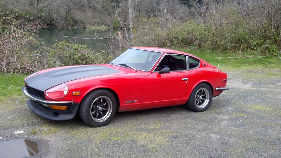

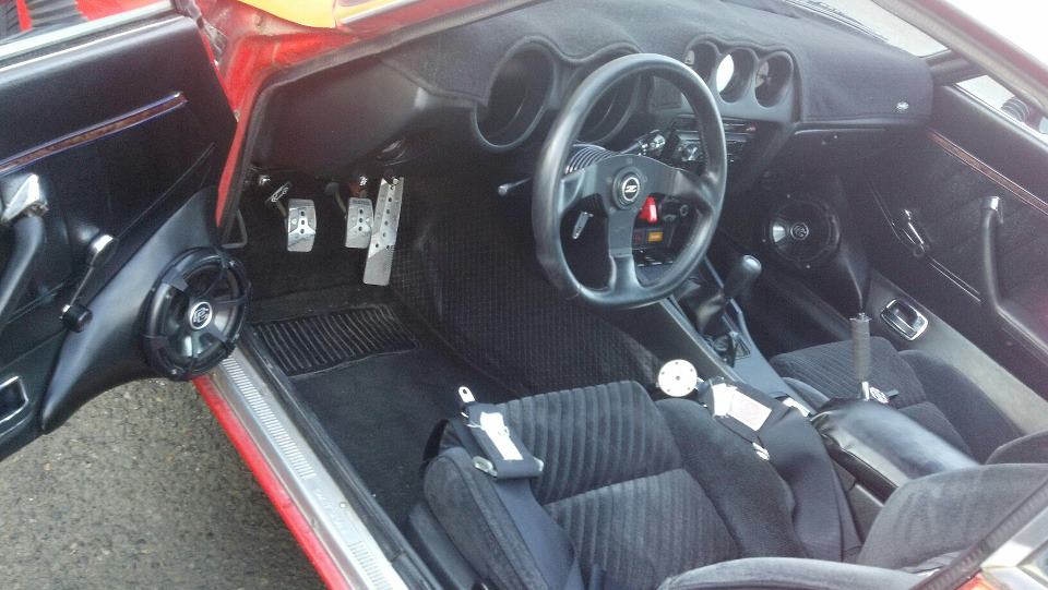

hello everyone, my name is Skyler, ive been wanting a Z car for years and finally got ahold of one last month,a 74 260, i will be posting pictures soon but its orange with black hood, old school konigs, and beautiful, interior is near flawless and has racing seats, track ready, short shift, and great custom sound system. ive been reading through a lot of forums and have found very knowledgeable people on this one so i thought id join this one. right now im running a l28 swap with 4 speed an dual su carbs. its been burning oil like mad so im using it as an excuse to give her some upgrades...i apologize if im asking questions that have been answered 1000 times but ive done hours of reading and havent found my exact situation.
