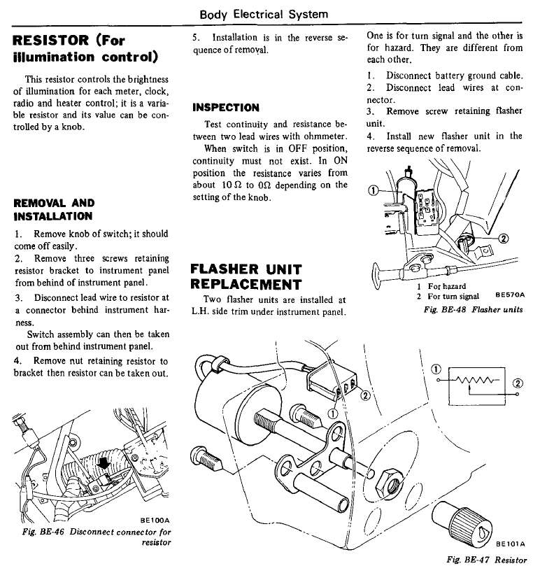

I just hit another problem with my 78 280z. The turn signals have stopped working. The fuse looks fine, and the hazards work.
Can someone point me in the direction of the flasher relay. I cant seem to find it and the manual isn't of much help either.
Old Apr 30, 2010 | 08:19 AM
From the manual (FSM):
