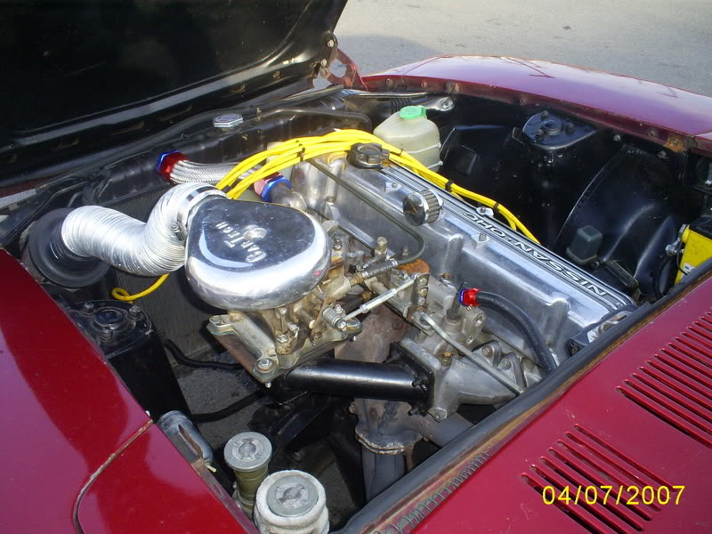

My car ran great with this Frankenstein setup. 2bbl motorcraft carb with a hand made manifold adapter, ported head, and a cam (forgot the specs). It got great mileage (28mpg on 100% hwy) and it was uber easy to tune/ jet down-up. Reliable. Not the prettiest though lol.

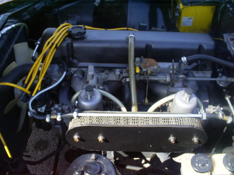

Then I slapped a set of 240z su's on it. Much prettier lol. I never really got them tuned perfectly. And my mileage went to dookie.
I miss my s30 now :/
