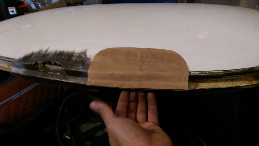

From some of the videos I've watch on youtube I used a paperbag to do my tracing

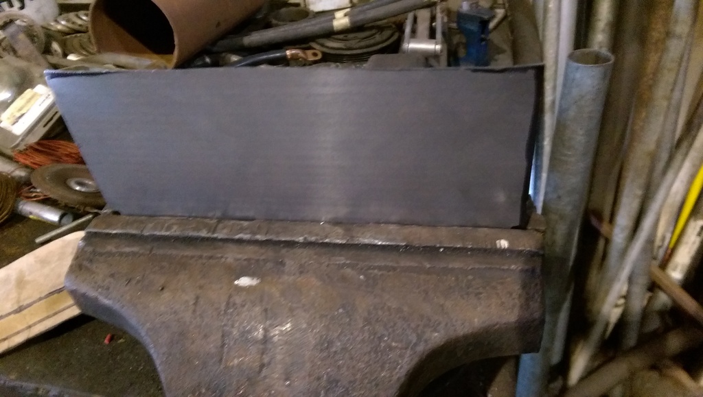

got myself a sheet of metal cut a square to match the paperbag template

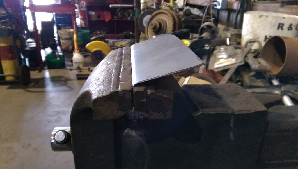

Now here is the sort of a issue, i dont have the proper tool to do the vents so i tried using this vicegrip
I align the line with the vicegrip and now i just pushed forward on it

not all the way and just left a what looks like a 20-30 degrees of an angle( i just eyeball it)
move it up to the next lineup
and bent backwards now
Its not perfect but looks ok

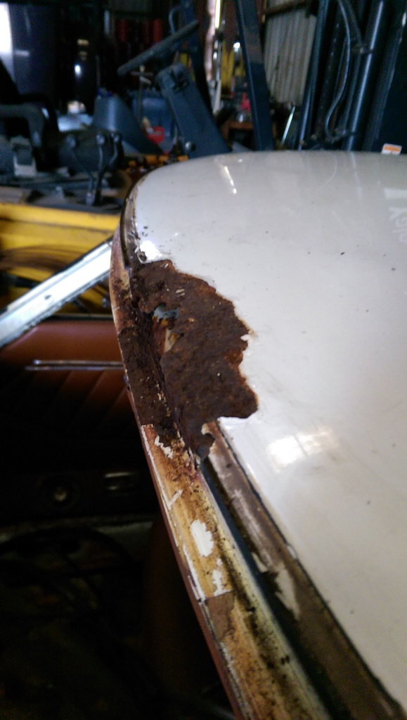

removing the cancer

Here is where I'm currently stuck and don't know what to use to eliminate the rust, for any of you guys out there should i used the eastwood rust converter or should i use another product
