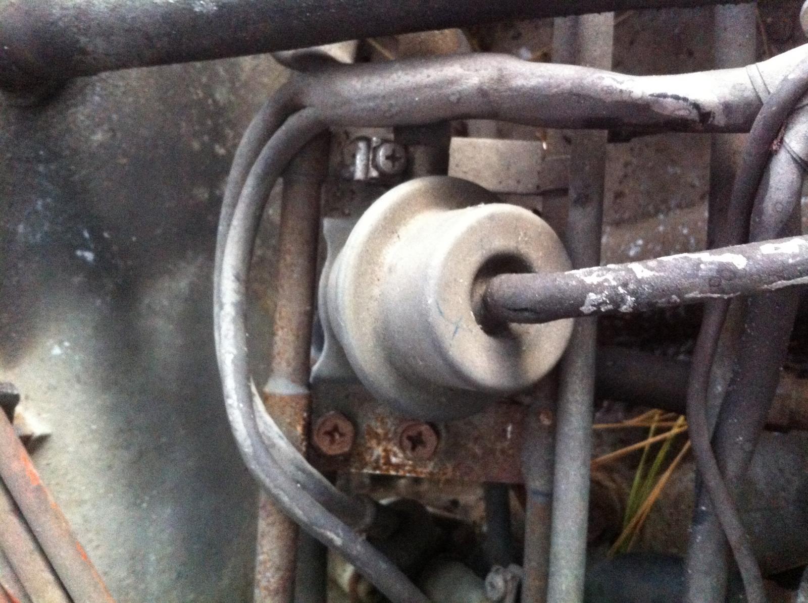

Alright guys, so I bought myself a 1978 280Z. The car sat for a while, I'm dealing with the fuel system now. So, I ran a quick little test tank setup using a gas can, hose to the pump inlet, hose directly from the pump outlet to the fuel rail inlet (no fuel damper, only gonna run it for maybe 30 seconds), and the return line off the return rail to the same gas can. Simple, right? Well, I hot wired the pump to run full time and within 15-20 seconds I got no fuel out of the return hose and looked up just in time to see the short feed hose i had ran looking like a balloon and then POP! gas everywhere. stupid mistake. The return rail is bone dry, does the regular not let any fuel out of the rail until the engine is running? sort of like a one way valve to keep fuel pressure? I noticed a vacuum like from the regular to the intake manifold. I also know the pump using stock wiring turns on for like 2 seconds and then doesn't kick back on unless the engine is turning over. Or am I dealing with some sort of blockage in the fuel rail?

Thanks for the replies everyone. I actually ended up downloading the FSM a couple days before posting this up. I used it to find a diagram of the fuel system and find out what the fuel damper was but I didn't think to check and see if it had an answer for me as far as the regulator. Checked it yesterday, sure enough it did. Long story short, I put all new lines in the fuel system and bolted the pump back under the car and ran a feed line thru the wheel well (wheel off of course) to the pump and the return to a seperate can in the engine bay so I could keep an eye on it. worked like a charm and the car fired up. it idled consistantly (a little high) and it stuttered when it revved but she ran after 15 years. I found out later that I forgot to ground the MAF so I cleaned up the ground wire and I put it back together. I'll probably see if it runs better today. If not, I'll start checking for dead injectors and maybe replace the plugs.
