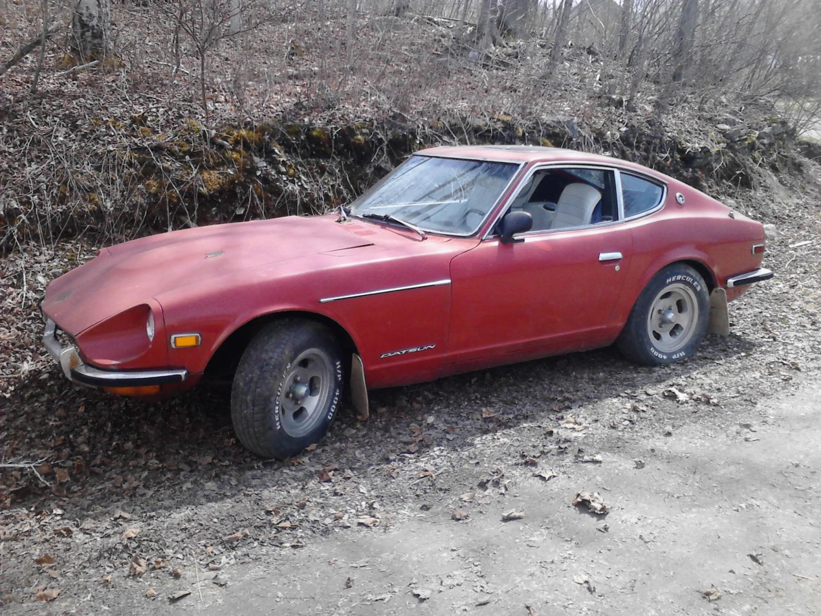

hey everyone.. so i just came home with a 71 240z.. its all stock and it was last on the road in 1989. its a really solid car, was stored inside, but needs alot of work.
im trying to make a list for myself of what to go through and inspect/fix/replace.
id like to drain and replace all the fluids in the car, whats the easiest methods to do so? what are some good fluids to toss in?
id like to check the cylinders for wear, good compression, sticking, etc.
was thinking about first just putting some marvel mystery oil in the cylinders and slowly cranking by hand and see what it does.. that ok?
best way to clean gas tank? i need to do this on this 240, and a 280 really soon.
anything i can do to help assist starting it up again?
really just want to bring this car back to life asap... but im in no rush to do so.
any help is greatly appreciated, thanks alot.. il try and post some pictures sometime.

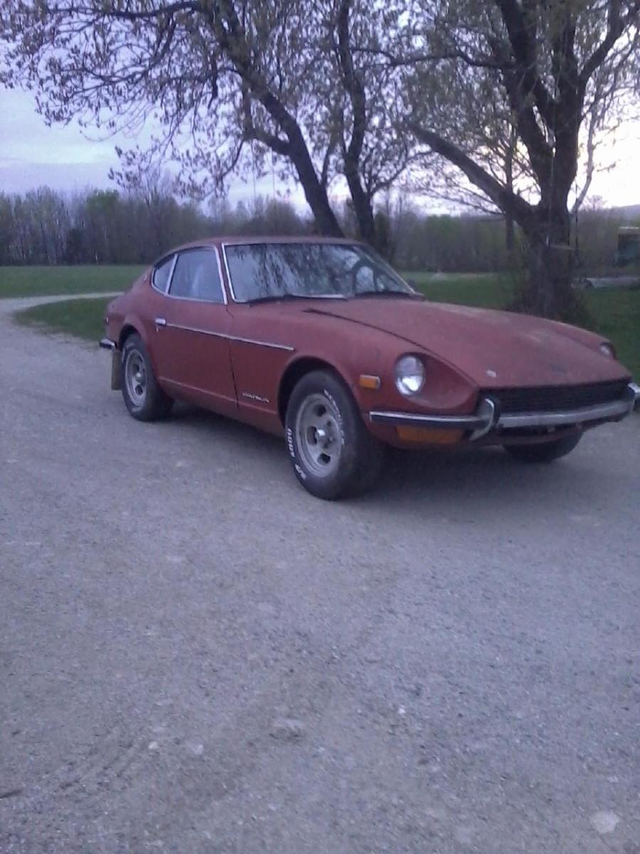

better late than never.. sorry bout the wait on pics.. project got put aside for awile as ive been playing with other z's and winter comming into play slowed me down too... but heres some pics of when i first bought it, and when i first started digging around in engine bay. engine bay is pretty now.. but need to take and upload more pics.
