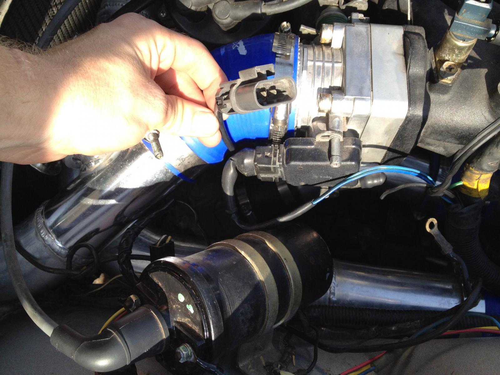

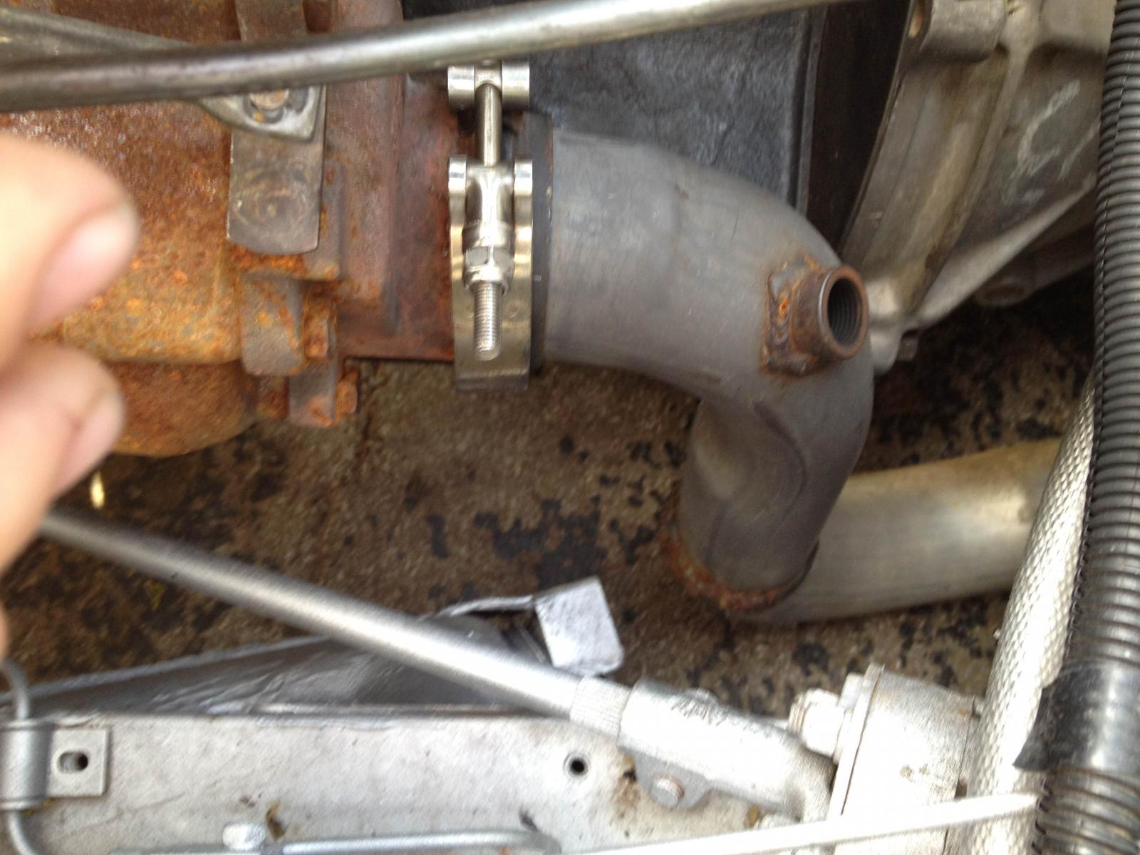

Hi all new to the site, just got my first but long awaited 240z. I have a few questions, one is what should i do with this hole? put an o2 sensor in it or plug it. if an o2 sensor is needed where should it plug in? My next question is where does this plug in? it comes of the tps and its just hanging out there. Any info would be great thanks!

Any intelligent ecu will need an O2 sensor... but we don't know what ecu you have.
And that open plug on the tps is for the potentiometer... again, only needed if your ecu needs it. Otherwise the normal tps switch is doing it's job just fine.

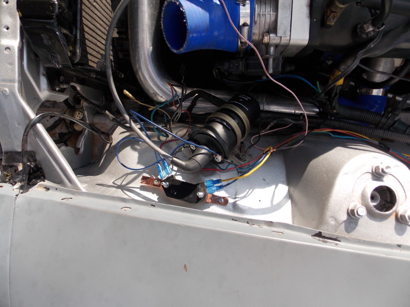

Went through all the wiring today and used actual wire connectors and everything is where it should be. However i am not getting spark. I reconnected the yellow/white stripe wire that runs to the igniter on the coil the way it should be and now im not getting spark. Should that wire be connected to a constan 12v sourse because even with the key in run its got no power to it. Please help!! thank you.

L28et swap no spark.
I have been over every wire and connection and ground and im still getting no spark. Im about to just start changing components like CAS, ECU, Coil... im just out of ideas. Any help would be great
Old Jun 13, 2012 | 07:00 AM
Is the coil bracket securely grounded? The ignitor grounds through the bracket.
I thought you said it runs? Did you move / change / touch something?
Old Jun 13, 2012 | 08:41 AM
taylor76zharris's Avatar
Joined: Jun 2012
Posts: 39
It did run...:/ all i did was put on o2 sensor in and use proper wire connectors to replace the old twist and tape method done by the engine swapper. I was very careful to reconnected every wier the same as it came undone. The coil ground looked a little iffy so i cleaned it up and still no spark, However i am getting power to the black/white wire in the same "T" plug . Im pretty sure that the YEL/WHT wire is not a 12V wire, its just a signal wire. Although at this point im not to sure what i know. I may just move coil to a much better location. Could something be fried in the ECU maybe?
Old Jun 13, 2012 | 08:50 AM
No, you aren't confused. The black w/ white stripe is 12V power, yellow is the trigger signal from the ecu.
Sounds like the ecu isn't getting power or is fried. Check to see if the green ecu LED light is coming on when the car is on (there is an inspection hole on the ecu).

Replace the ignitor with an HEI control module out of a chevy vette. Only $25. I had a similar problem with no spark, had 12V on the black/white wire but nothing from the yellow/white. ECU light was on. Swapped it out and got spark.

Im pretty sure i did this right, still nothing though. Heres a few pictures of it

Oh, so you do already have the HEI control module swap... If I don't forget, I'll pull out my Voltmeter and start checking the connections when I get home tonight... I have to run some errands after work
During my troubleshooting of no spark, I had pulled the distributor out but left it connected to the wiring harness. I then put the key in the 'on' position and then rotated the drive shaft of the dizzy. If the CAS/wiring/ECU are functioning you should be able to hear the injectors firing. This was helpful to me because it can be hard to hear the injectors over the sound of the starter. It may not be the best way to test, and maybe someone could pipe in. I don't recommend doing it just yet as it was running before you started to correct the wiring.
A quick check to see if the ignition relay is functioning is to see if the power windows work. They get power through the ignition relay... thats why they only work with the key in the 'on' position. But I think the ECU gets power through it too, so may not be needed.

I did it like five minutes after i read your post hah. But yeah still nothing. Do you or anyone out there think it might be the ECU? Like maybe just the circuit that is used for that wire? Another thing that i think is weird is when i hook up a 12V test light to a 12V hot wire and touch that yellow/white stripe wire with the probe it lights up?
