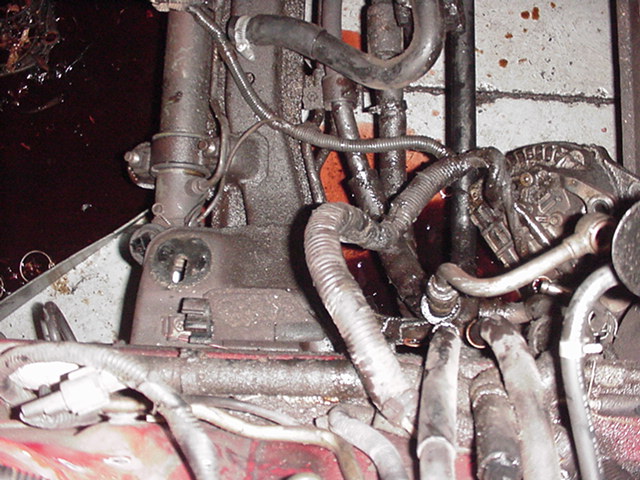

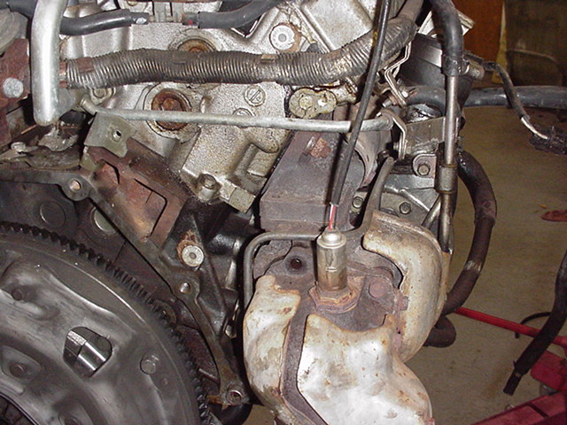

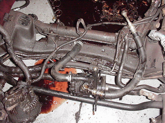

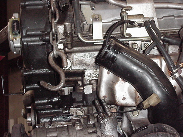

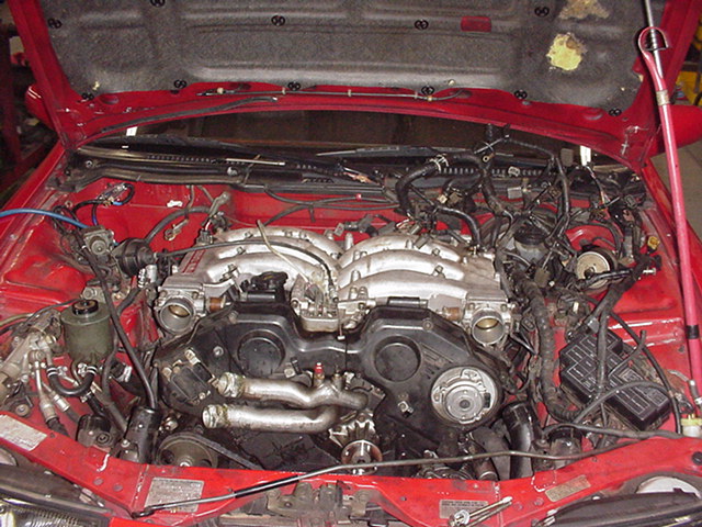

Thought you might like to see some pics of the process.. thanks for being understanding and patient. Bill

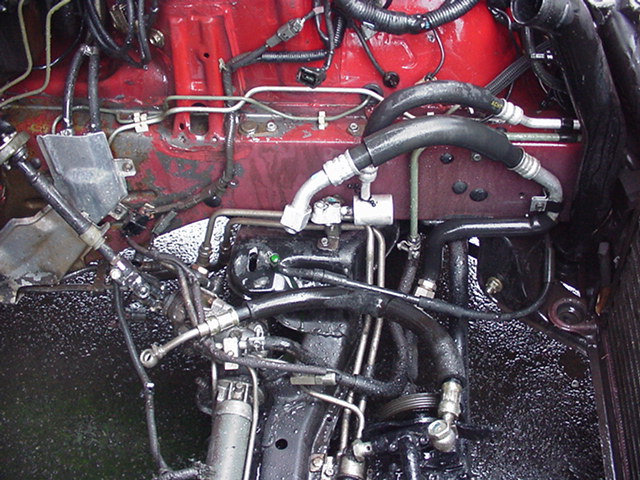

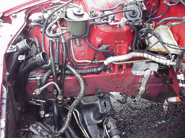

leaks and such

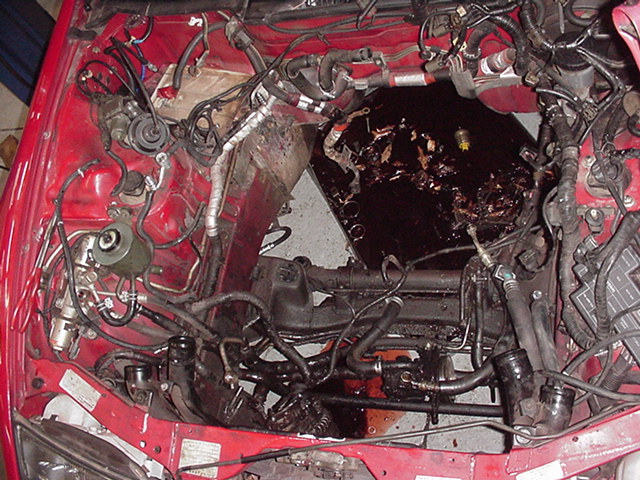

Yea, we had oil leaks, the water pump shot, and knock sensor dead, the intake manifold would have to be pulled to do that so I pulled the engine to totally reseal, we are going to install a hard line kit for the waste gates, and replace knock sensor and knock sub-harness,, along with all new turbo water lines and vent hoses. makes for a much cleaner job.....

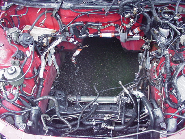

Bill do you have the means to pressure wash that engine bay with some engine cleaner or something! will make it less messy to re-install also, Do you figure ill have it back this week?

Done
As you probably have seen already that has been done. Af I every pull a motor and the bay is dirty, it always gets pressure washed.
