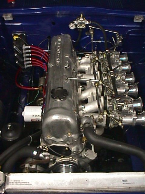

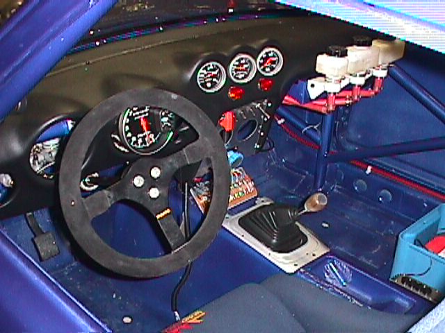

John's car isn't radically different from mine. It's basically an FP car that can do duty on a road course. The cage is pretty much overkilled for an autocross car and he has semi big fuel cell (for an autocross car). The brakes are overkilled etc... The only thing he's done that I haven't (yet) is tubular conrol arms. He built some pretty simple ones that are not adjustable on the car. He also spent the big bucks on a Rebello motor. Otherwise it's about the same as mine, except blue!
I'll try and post a few pictures...

Welll... that didn't work... Let me try again...
Attached Thumbnails SCCA SOLO 2 Nationals Results-jt-mvc-002f.jpg   SCCA SOLO 2 Nationals Results-jt-front-brakes-.jpg   SCCA SOLO 2 Nationals Results-jt-rear-brakes-.jpg   SCCA SOLO 2 Nationals Results-susp1a.jpg   SCCA SOLO 2 Nationals Results-jt-mvc-004f.jpg

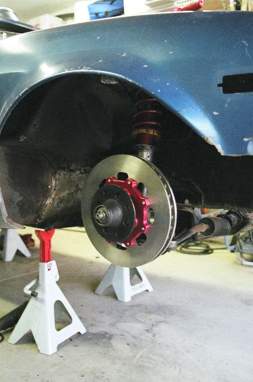

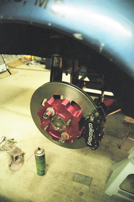

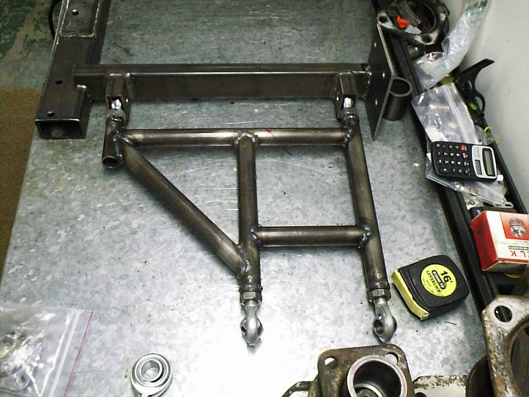

I'm not using formula car parts for anything other than inspiration. For the heims you'll find it takes a lot less effort to move them when they are mounted with the bolts up and down. Since we don't have a lot of suspension movement you don't need to worry about binding. Try putting one in a vice and moving across versus rotating and you'll see what I mean.
I would change the orientation of the front control arms and TC rods to work the same way. It's a number of small details like this that end up making a difference.
Another trick is to spin the heims to clearance the teflon liner. You put them in a drill prress and turn them until they start to tighten. Then immediately dunk them in ice water. This shrinks the liner a minute amount.
Here are a couple of pics of the rear suspension.
Rear view of suspension

Hey Cary. you wouldn't have a spare set of those arms laying around would you? I found all of the Hybrid threads last night and I assume that is a toe link on the back of your arms and geez, will you please finish your monster so we can all be in awe. (oops... I can't say anything about construction speed) Out of curiosity, would using long arms like yours in the rear with stock length up front cause weird things to happen?

It might make the back stick better. The long arms help to change the amount everything moves. You get less movement of the contact patch and things like IC, RCs, and all those other peskies calm down.
If you're going to keep the stock front arms I'd make it more like John's with a little shorter arm. The toe link is in the back and really serves no other purpose than to let you adjust toe easily. Obvisouly this hasn't been used in combat but the design has on other things and seems to work. So we'll see.
I have a jig so for the rear arms so they aren't that hard to build. They won't easily fit a stock car as I tried to use them on my current car. I raised the diff on the tube car to make room for them. And the tube80 has to get finished this year. I'm getting rid of the parts car so I won't have anything to run unless I finish it. That is my main motivation.

I assume the arms are made from chromoly?

This is on the cheap, plain ol' mild steel -- just thicker. If it all works maybe the next one will have some better materials. The chassis probably costs around $500 in metal total. It's the $15K in parts that are hung on it that are expensive. This project is really about building a fast car with as much ordinary content as I can and only spending money where needed (or that's the story I'm sticking to).
