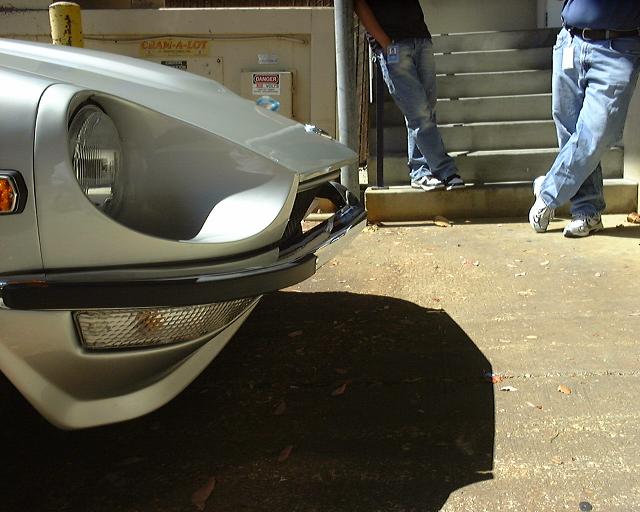

Stripped to the bare shell, fully seam welded unibody and FINALLY painted...
3 Piece Panasport Racing Wheels w/255/45/17's ALL THE WAY AROUND!

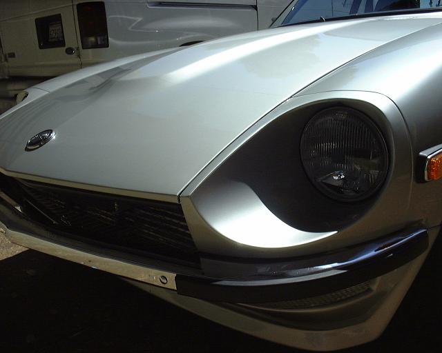

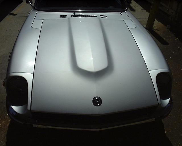

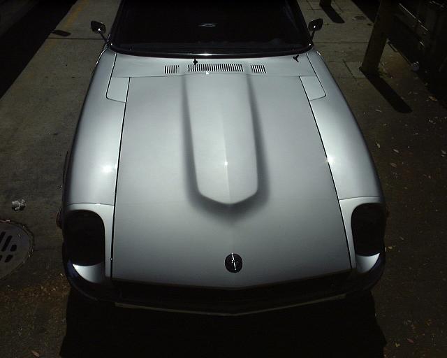

Getting a final inspection!
The final product...
And yes, after today, I can confirm it will do at least 125mph!
(obviously, on a closed course race track...)
