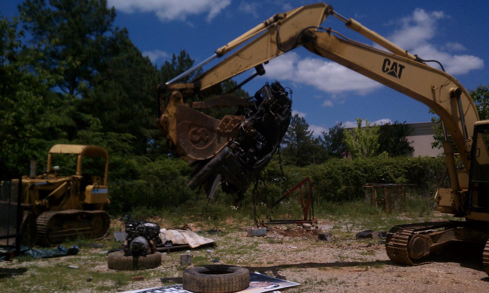

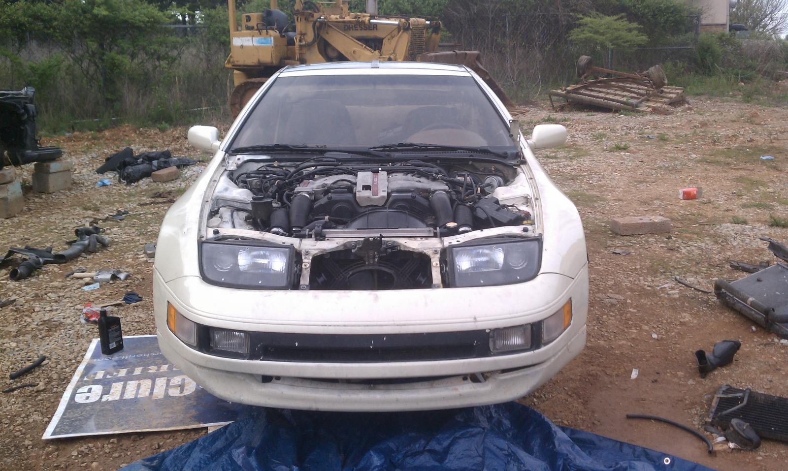

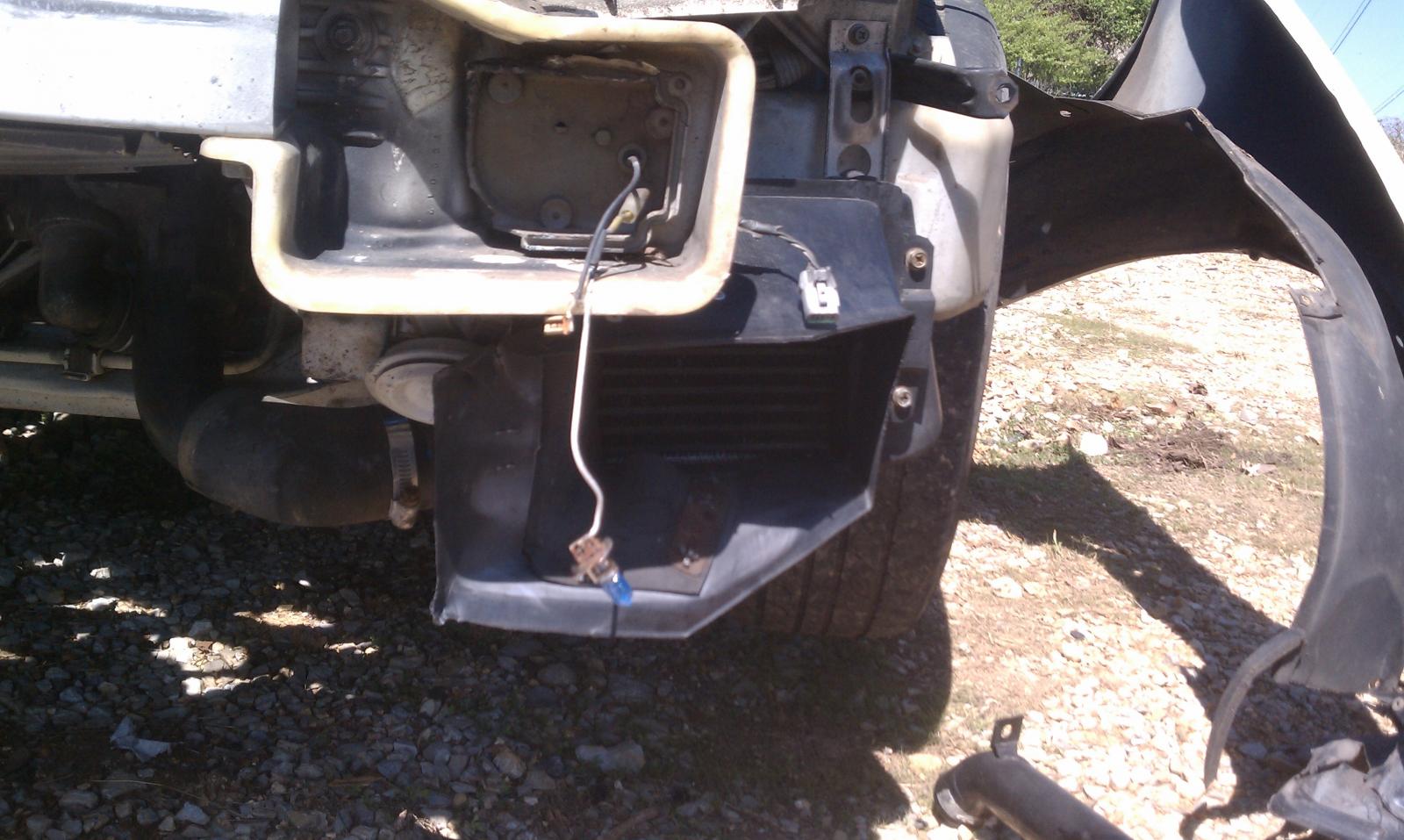

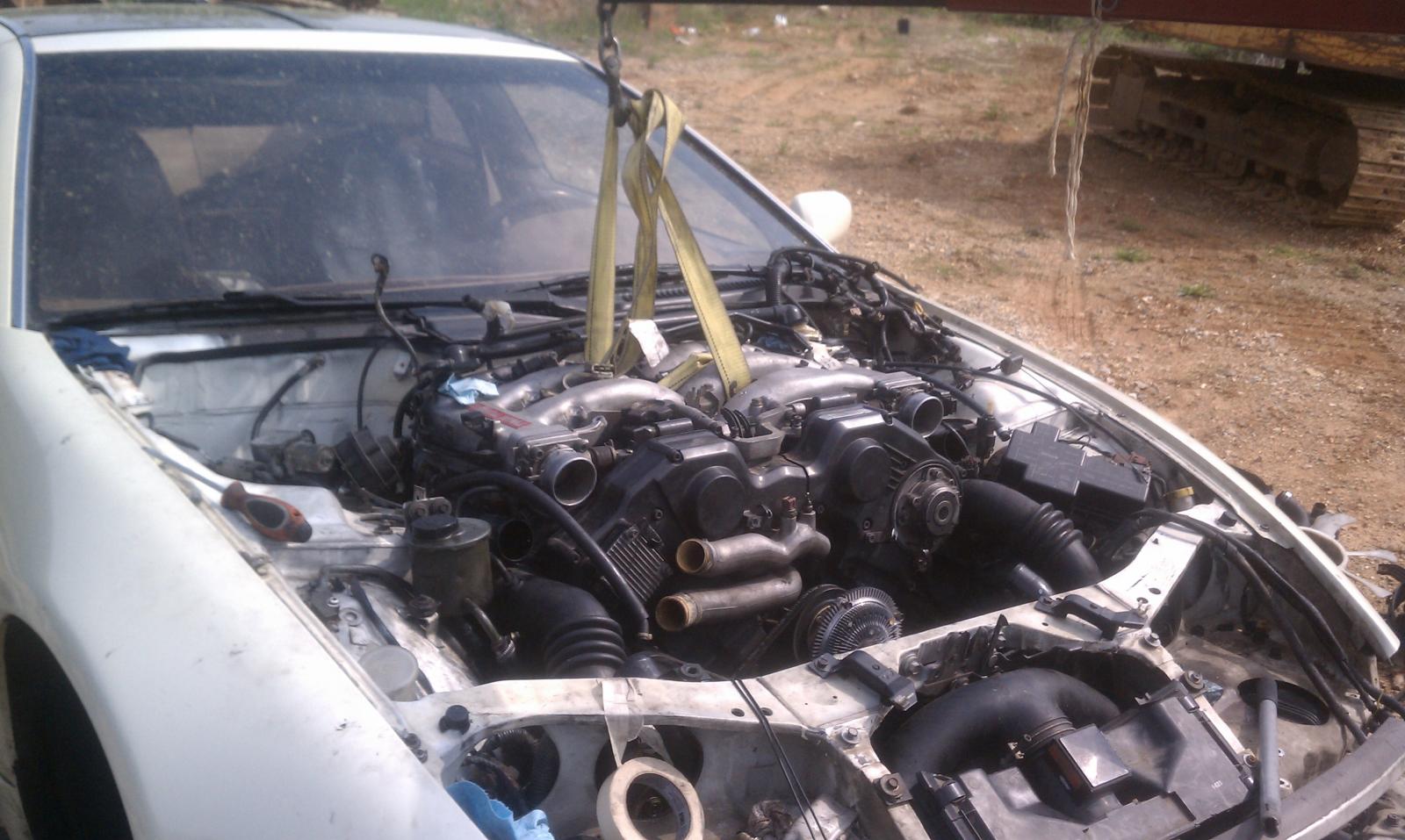

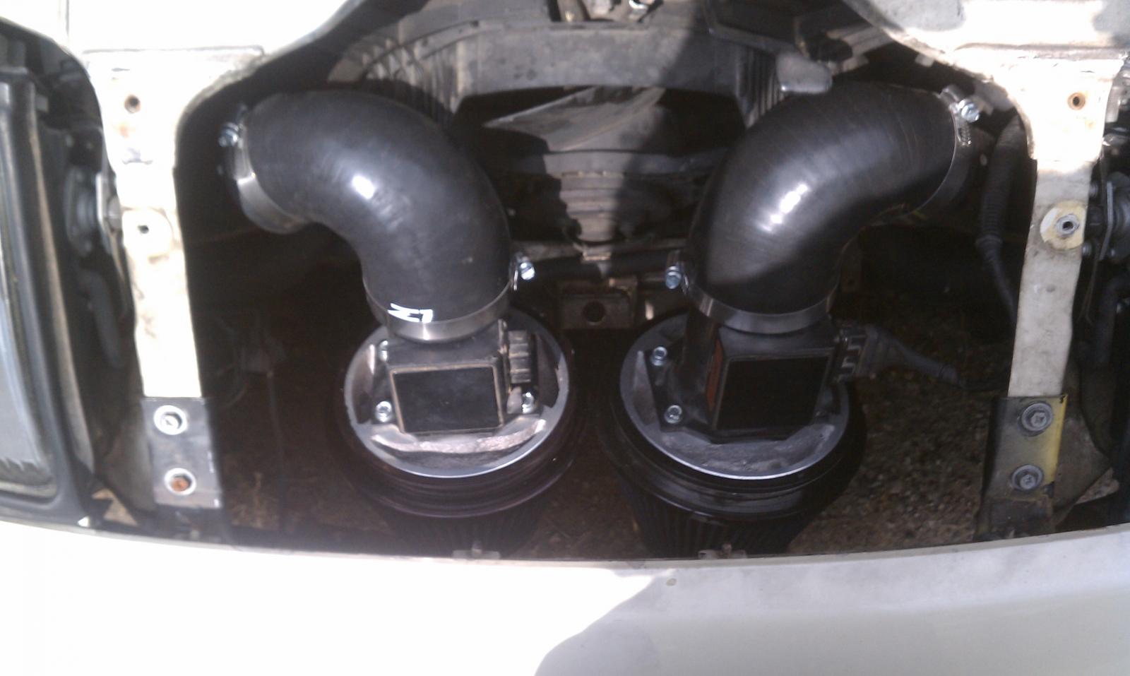

Sorry it took so long, but here they are...

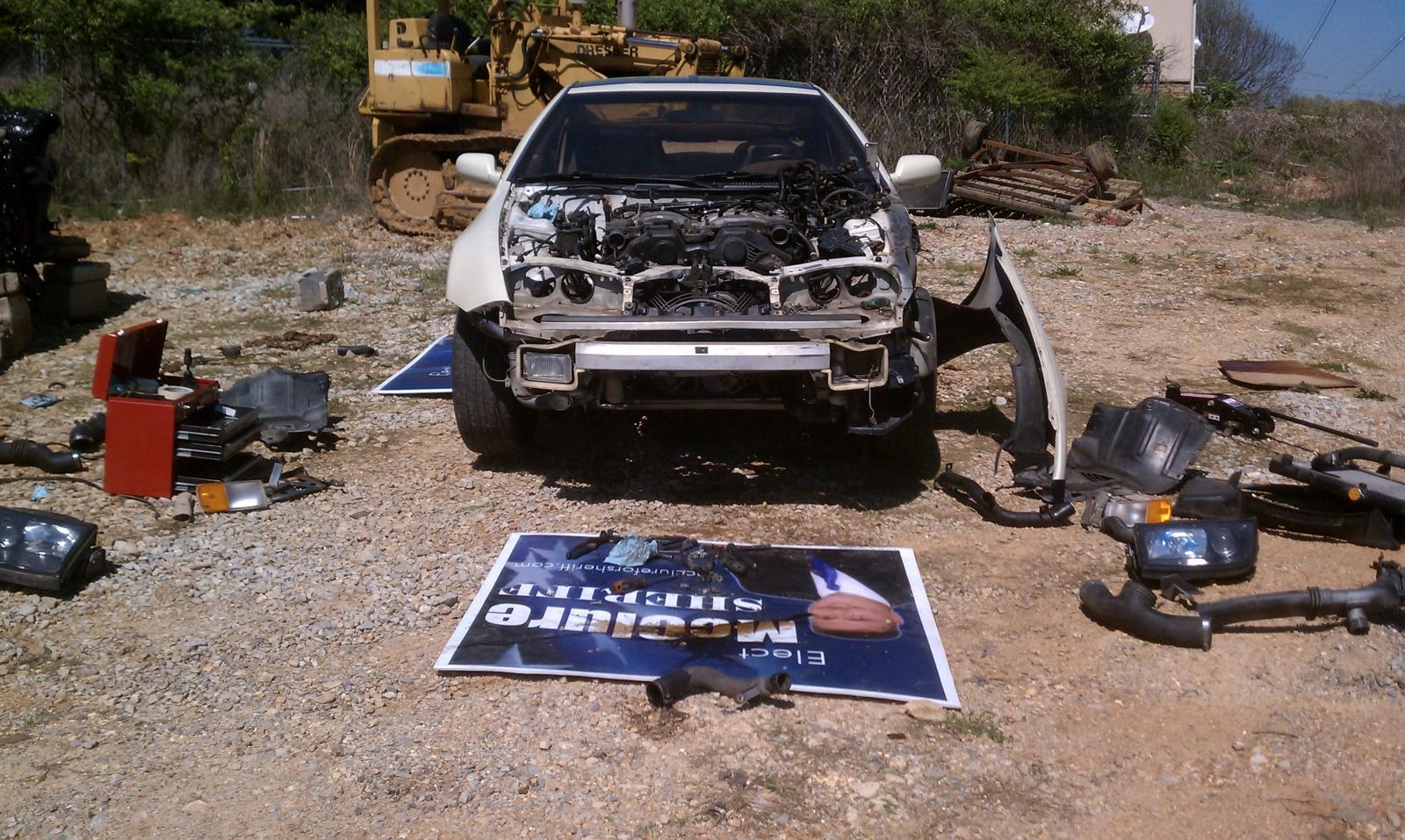

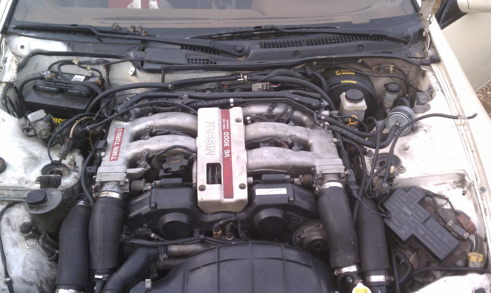

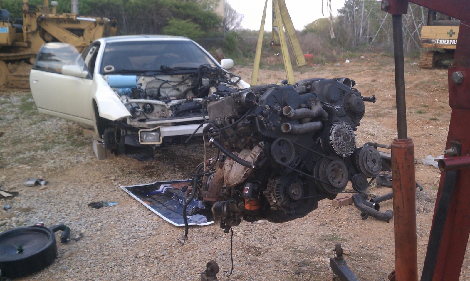

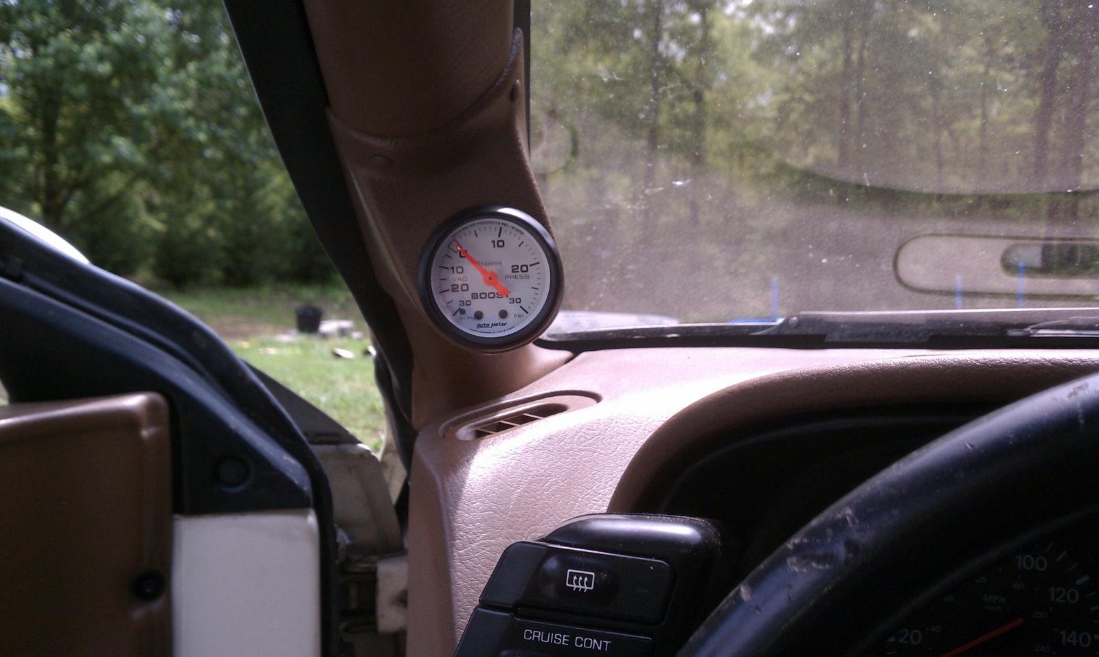

Attached Thumbnails Want to do TT Swap-321.jpg   Want to do TT Swap-322.jpg   Want to do TT Swap-323.jpg   Want to do TT Swap-324.jpg   Want to do TT Swap-326.jpg
Want to do TT Swap-329.jpg   Want to do TT Swap-332.jpg   Want to do TT Swap-334.jpg   Want to do TT Swap-340.jpg   Want to do TT Swap-341.jpg

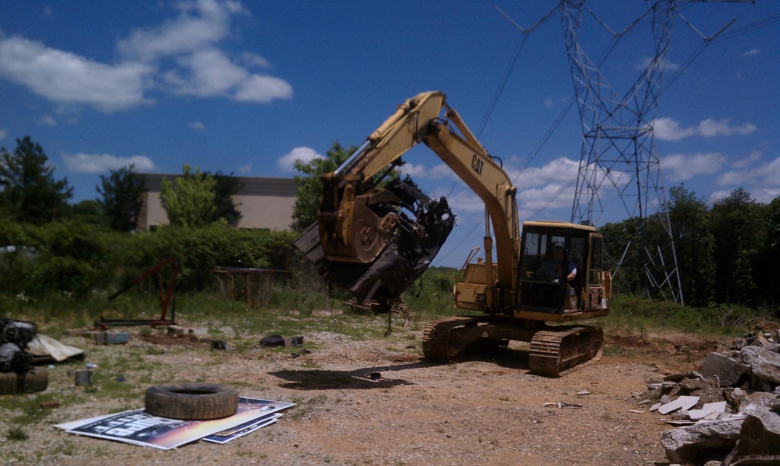

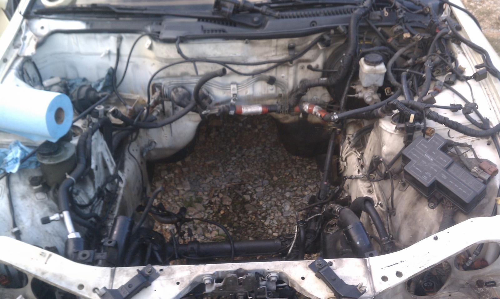

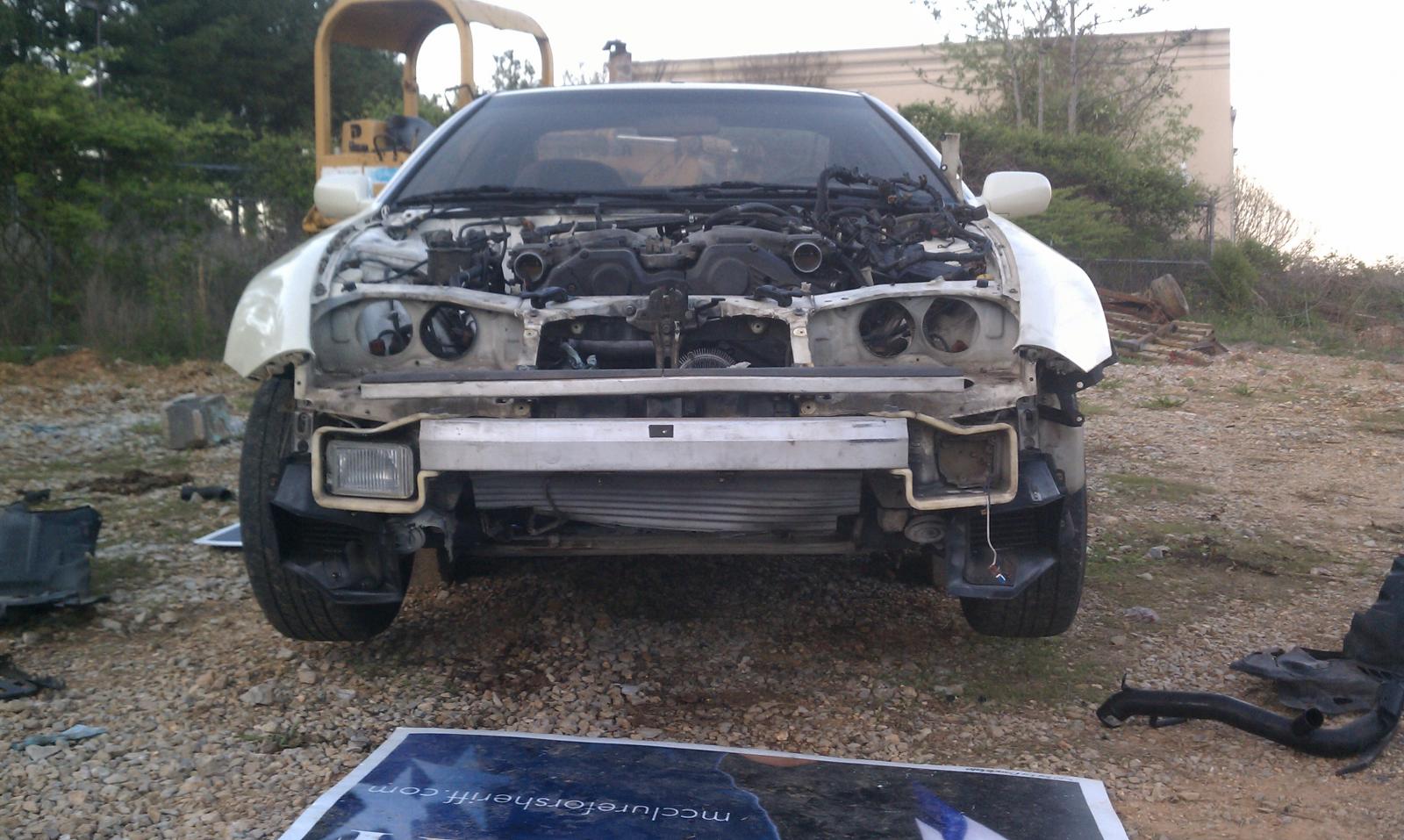

Here was the fun part...
