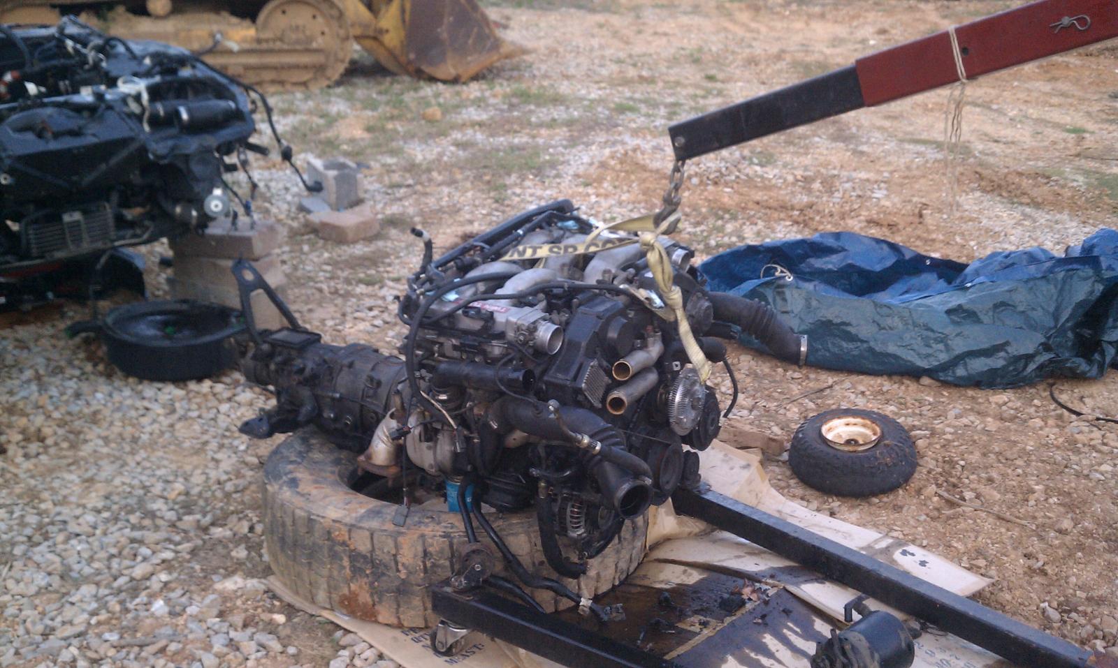

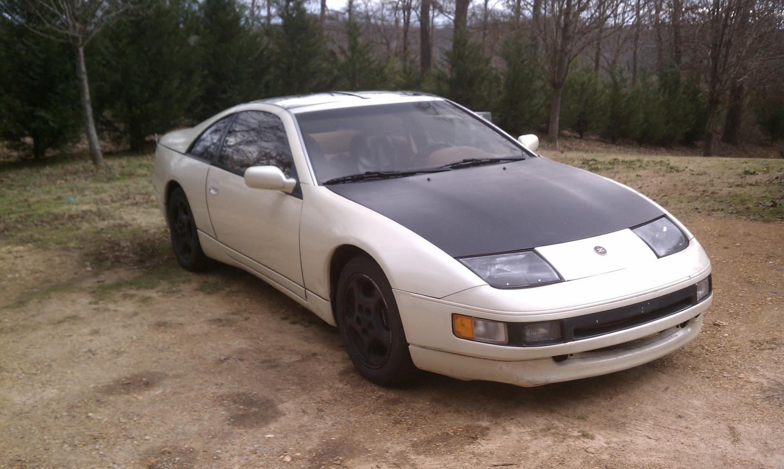

This is the lucky candidate for the TT swap.

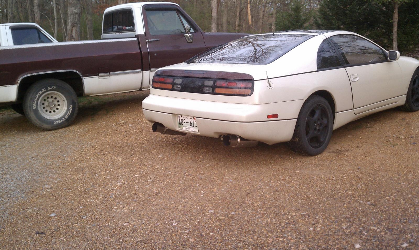

Picture of the new exhaust.

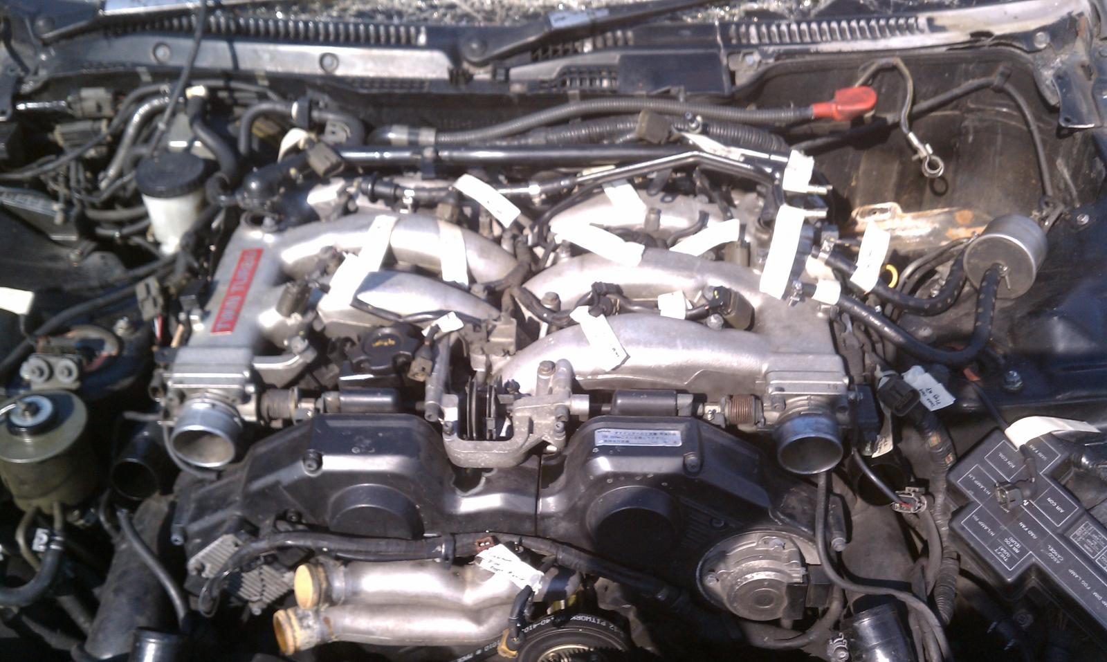

The day the clip arrived.
That's what I like to see.

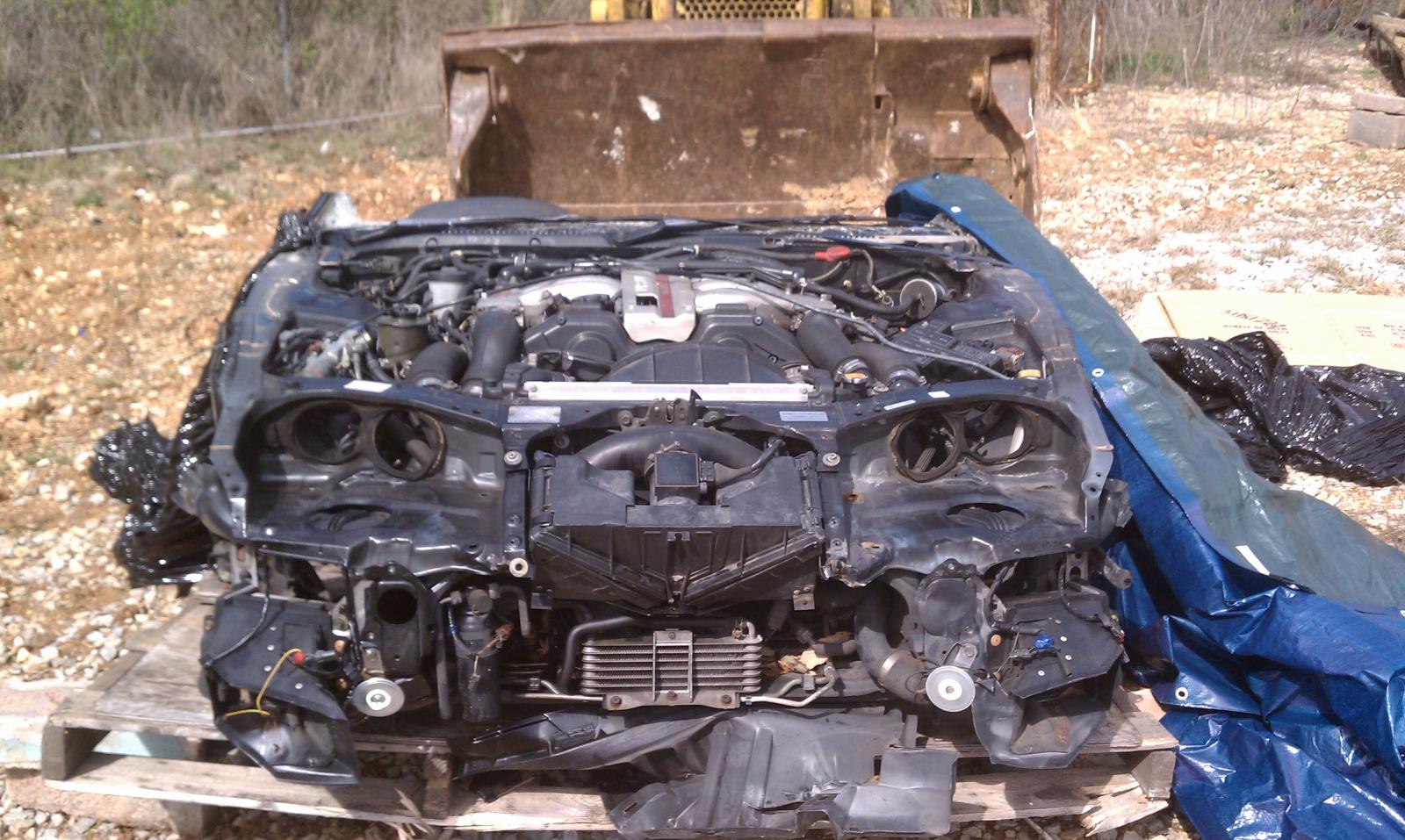

Picture of all my labels.

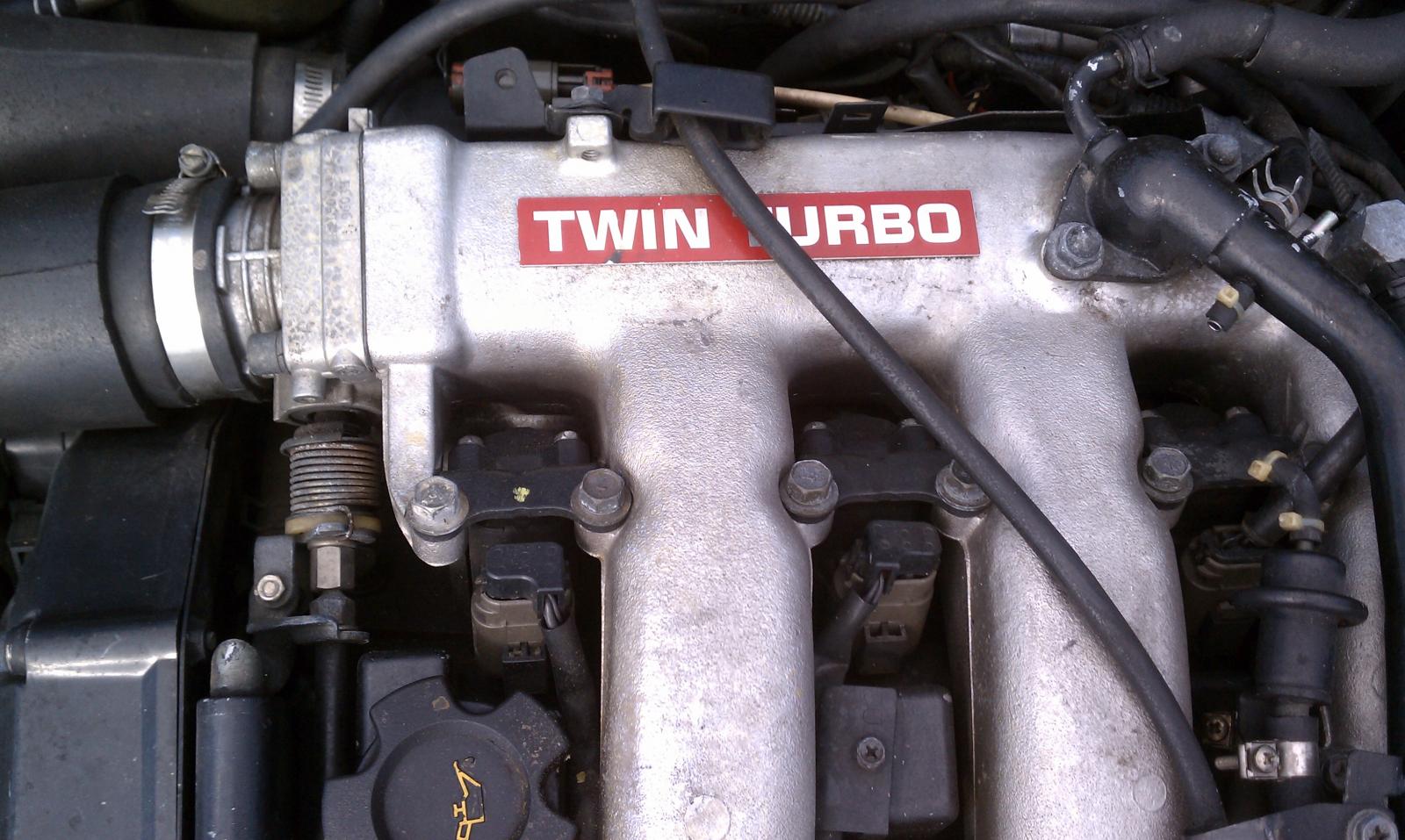

After a lot of sweat and my calves got sun burnt.

Wow, that clip looks pretty clean. Did you end up getting it from conceptz? How's the condition of the wiring harness?

Yes it is very clean. The harness is in great condition. Going to reuse it. Intercoolers are undamaged except for the very corner of the plastic shroud on the left one. The inercoolers their selves are untouched. Can't wait for Monday so i can start back up.
Believe it or not the motor mounts aren't even hardly dry rotted. They could be reused, but I already have some Z1 Urethane Mounts. I've got new spark plugs, my Z1 ECU showed up today.
