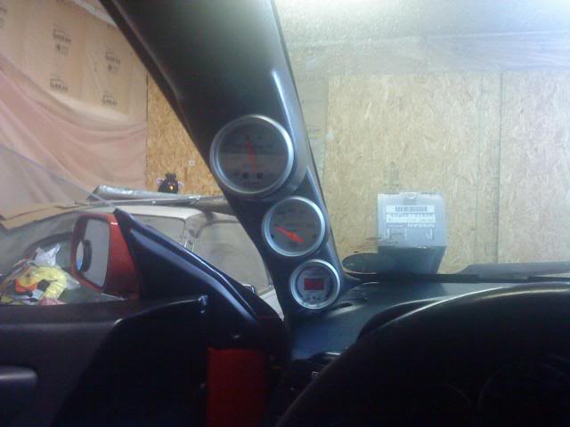

Got my gauges installed...

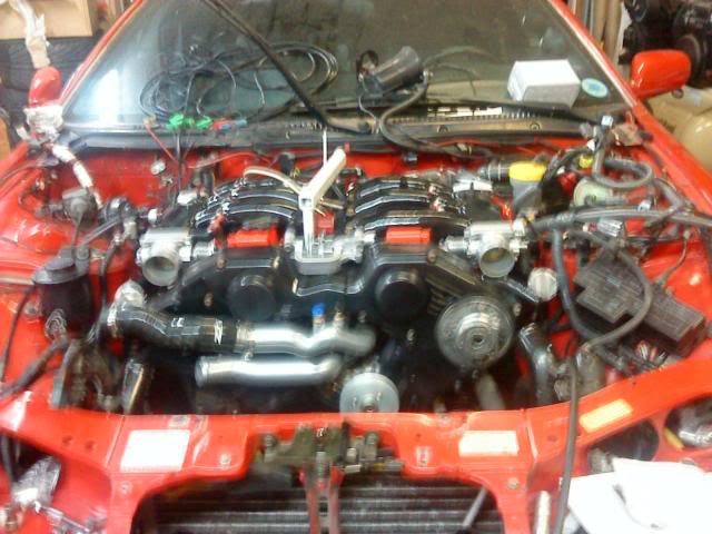

and got something else installed....

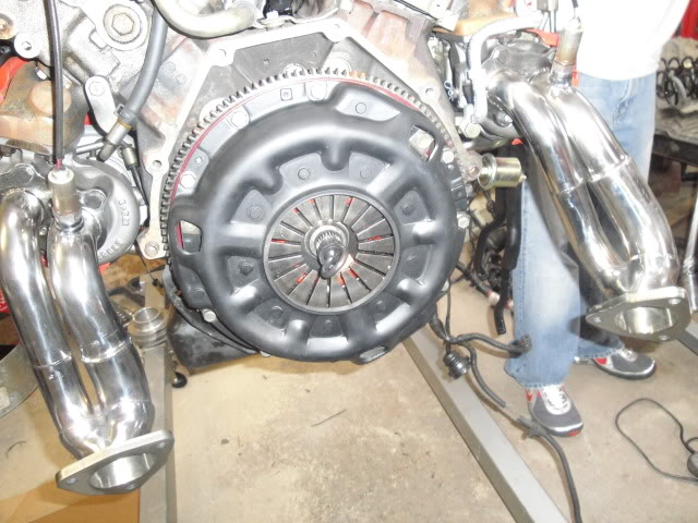

Got the flywheel and clutch on.

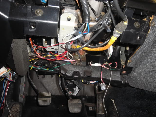

Now I get to deal with this wiring nightmare I found when I went to install my turbo timer.... This was the "security system" that the previous owner had installed / installed....
The wires with yellow zip ties are what I wired for my gauges... Looks way different than the wiring that whatever tool did this.....
