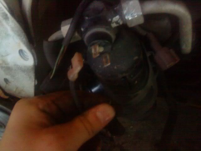

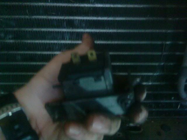

but i do have a quick question... this was mounted above the oil cooler, and i'm not quite sure what it is... I could tell by the wiring job that it was not factory...
This was unplugged, and had 2 wires on the prongs running to...
this, which was mounted on a bracket above the oil cooler. I found the plug on the harness that was supposed to go onto these prongs...

nobody knows what this rigged in piece was?

Hard to tell as the pics are not clear and are too dark. It appears to have something to do with the AC system. The canister it's plugged into is the evap canister (if I'm seeing the pic correctly). It looks like some sort of replacement pressure sensor for the stock unit. Never seen that before and also not sure why they did that.

yeah, those pics blow, im not sure what im supposed to be judging, is it only that spade clip looking thing in the first pic and then the block int eh second? the block looks like a large relay or something of the sort
