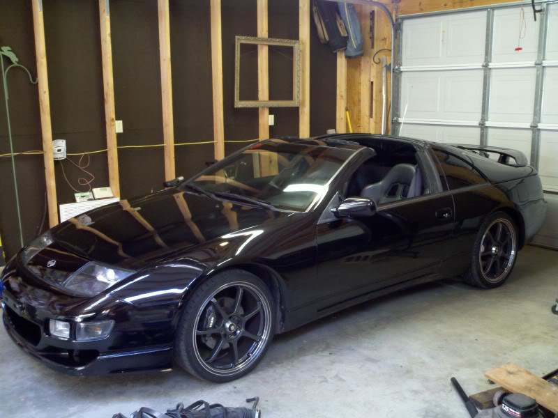

Hey guys. I just traded into a 93 2+2 NA, and it's having a kind of wierd issue - while the cruise is set the car will maintain speed, then drop back 3-5 mph, then a surge of power brings it back up to set speed (sometimes 3-5mph over set speed. Then the pattern repeats itself. There are also seemingly "dead spots" in the powerband and different throttle inputs yield different results. 1/4 throttle and the car seems to have no "pull" but any further into the throttle it picks up. The previous owner said that it needed new PCV valves - could bad PCV's be the issue? Thanks a lot guys. This is what the car looks like BTW.
