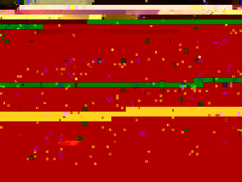

Found it! further back that originally though - rear of tranny?!?
Found a leak at the rear of the tranny that is dripping on the passenger's cat.
Look at the picture here - what am I up against? Note that the tranny is clean, and the front u-joint of the driveshaft is still reasonable dry.
Old Oct 29, 2004 | 03:16 PM
lightspeed's Avatar
Southern Speedster
Joined: Aug 2004
Posts: 179
Looks like a rear tranny oil seal. How hard is it to remove? - the on-line guide show a special puller - can I do it with a "regular tool" of some sort?
Old Oct 29, 2004 | 04:14 PM
91zxtt's Avatar
Joined: Nov 2003
Posts: 3,672
From: Gerber, CA
Definitely rear tranny seal. Tranny fluid stinks really bad; especially when your burn it. We didn't use a special tool when we changed my seal. We used a punch to press out the old seal. Don't ruin the seal though, because it is good too use to press the new seal back in. It's the same as removing one of the cam seals, so if you've done that, then you should be fine. You'll need to drain the tranny fluid, or it will leak out the back.
