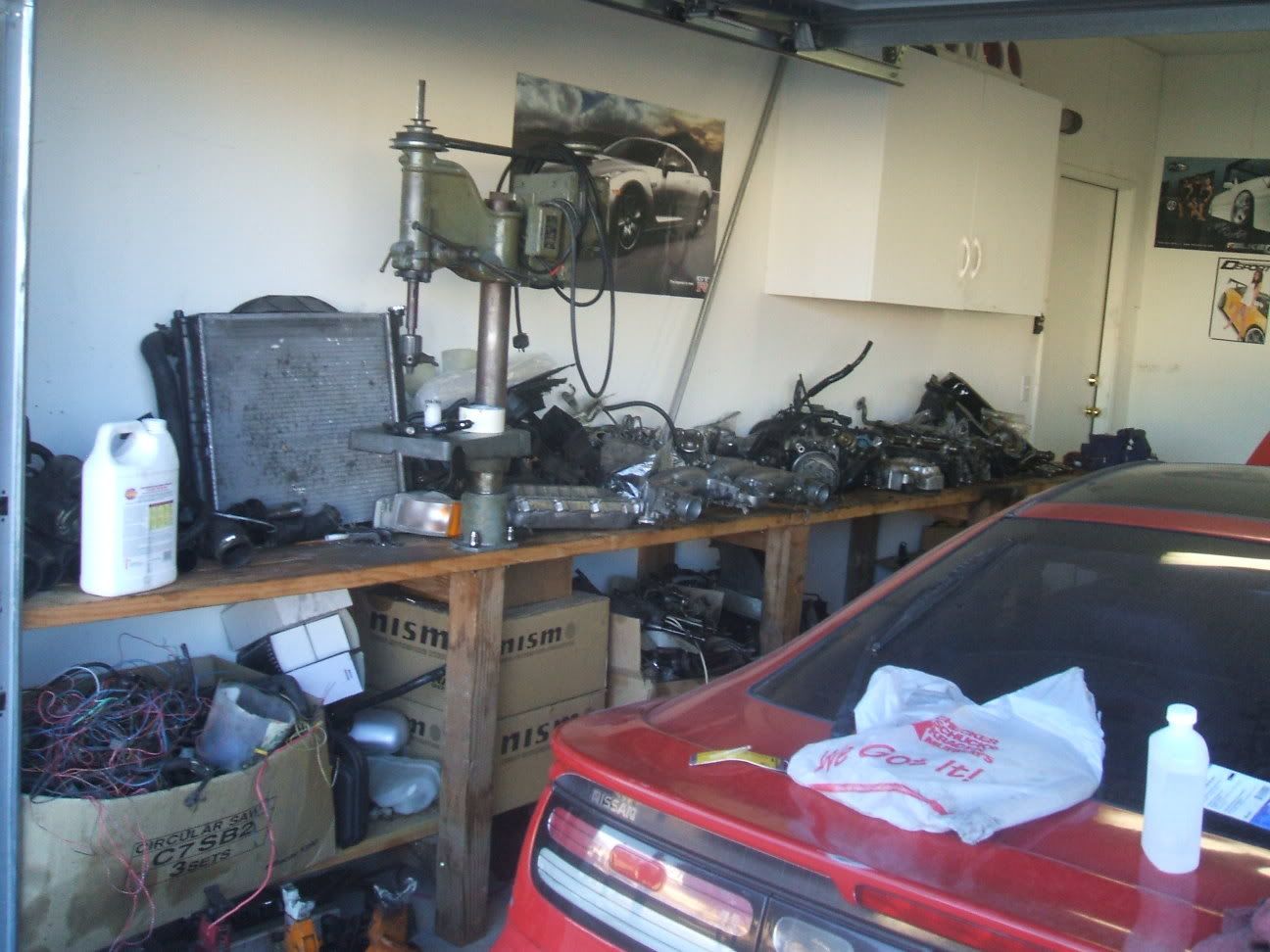

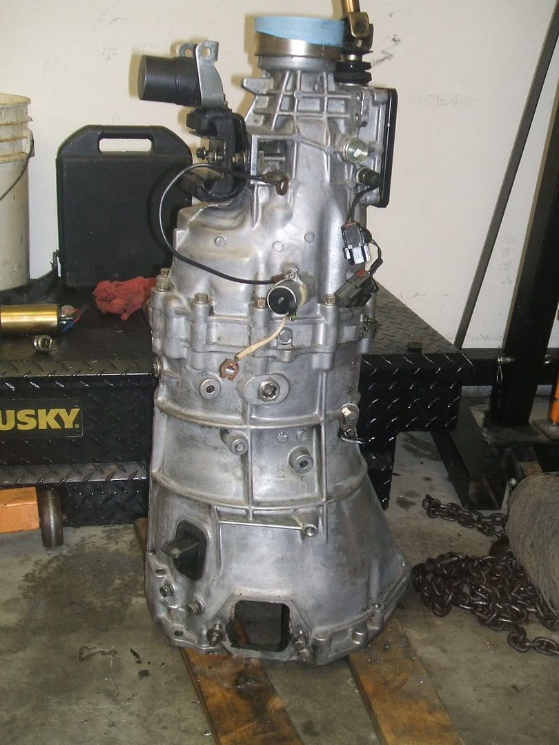

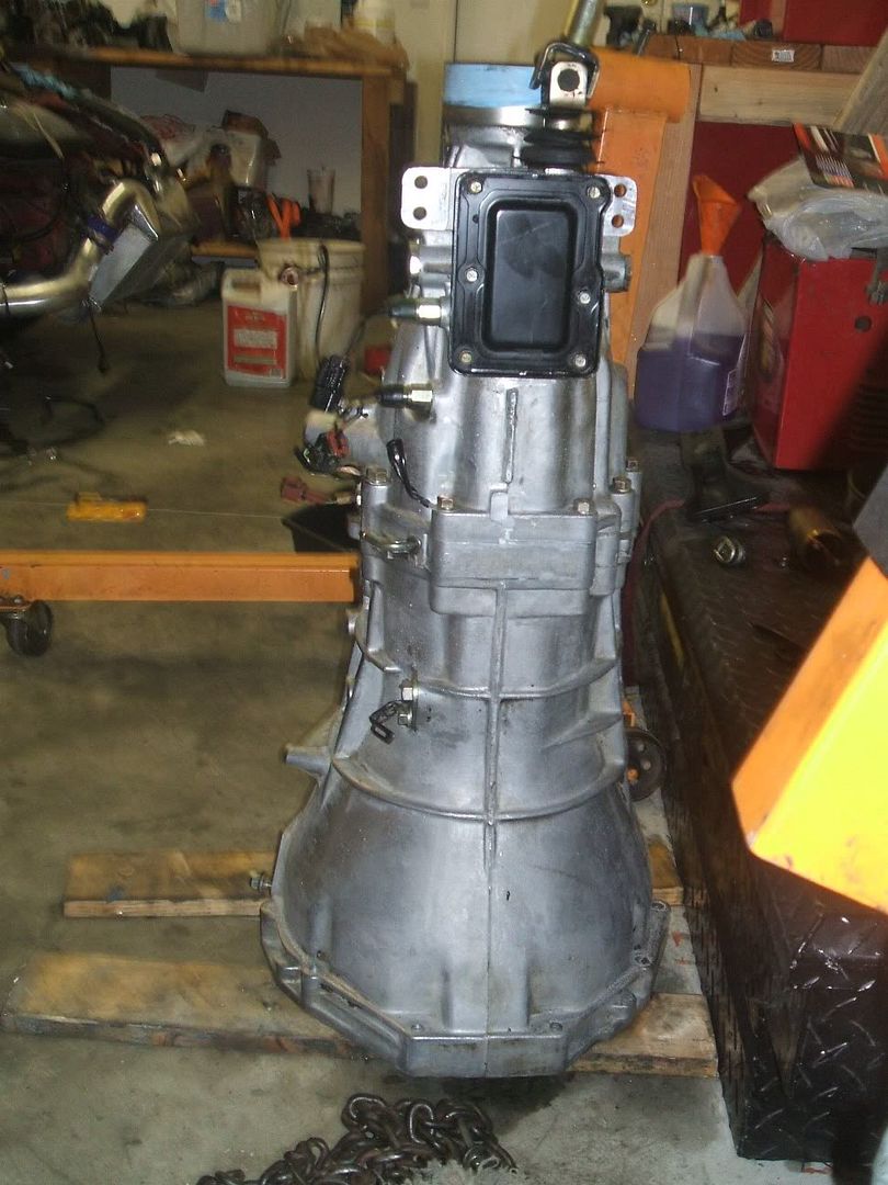

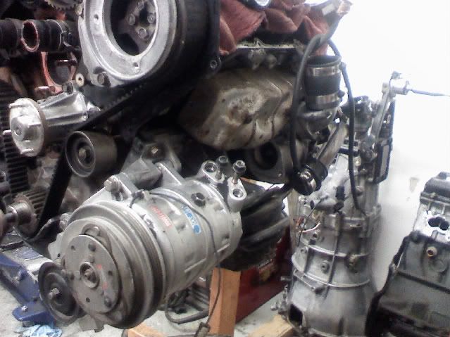

and now idk how many months later i pushed her in the garage, took the engine out. then yesterday i tore the engine down to the bone!, this is where i stand machine work will begin soon. look forward to engine build pictures.

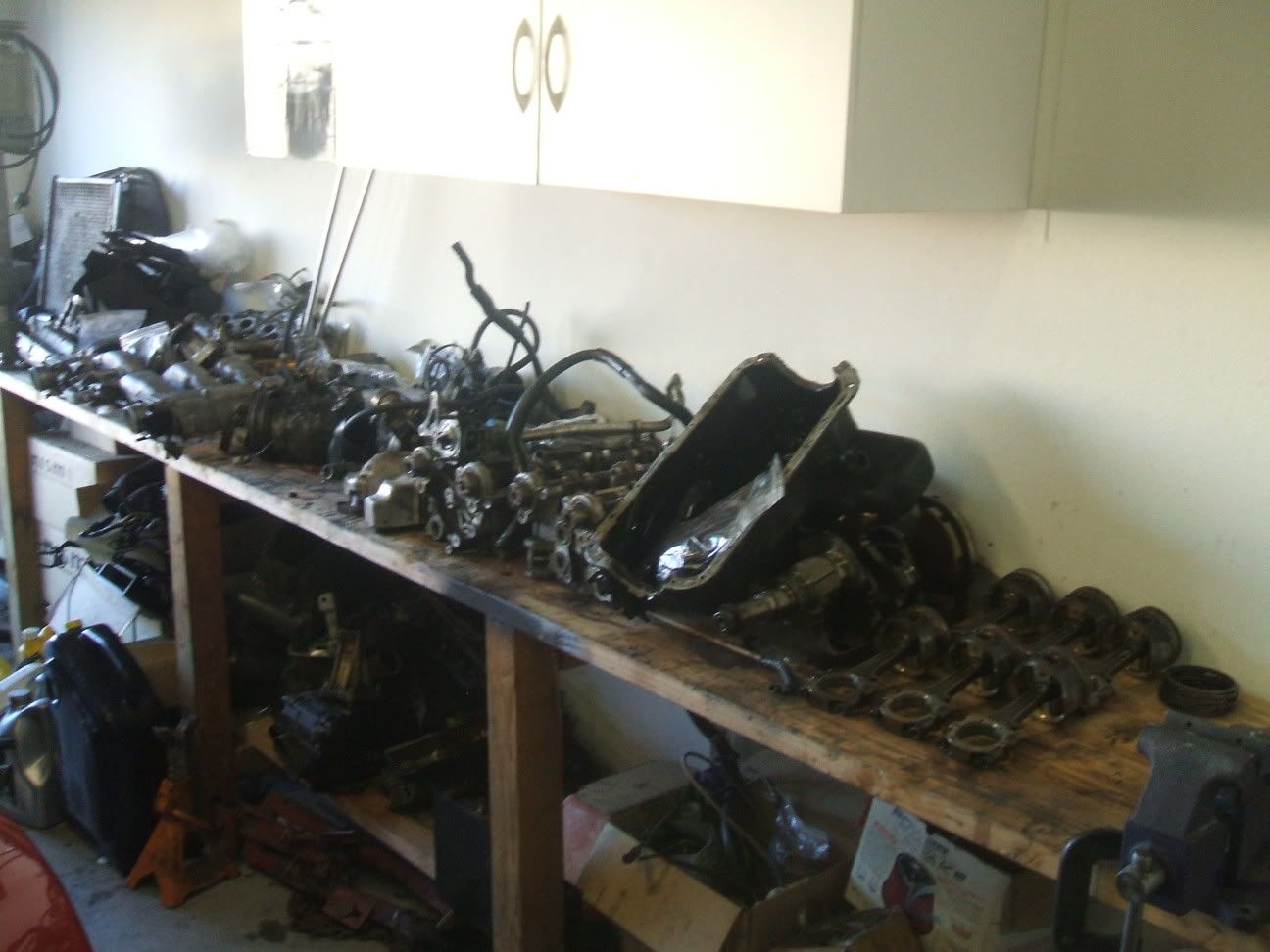

Parts parts parts

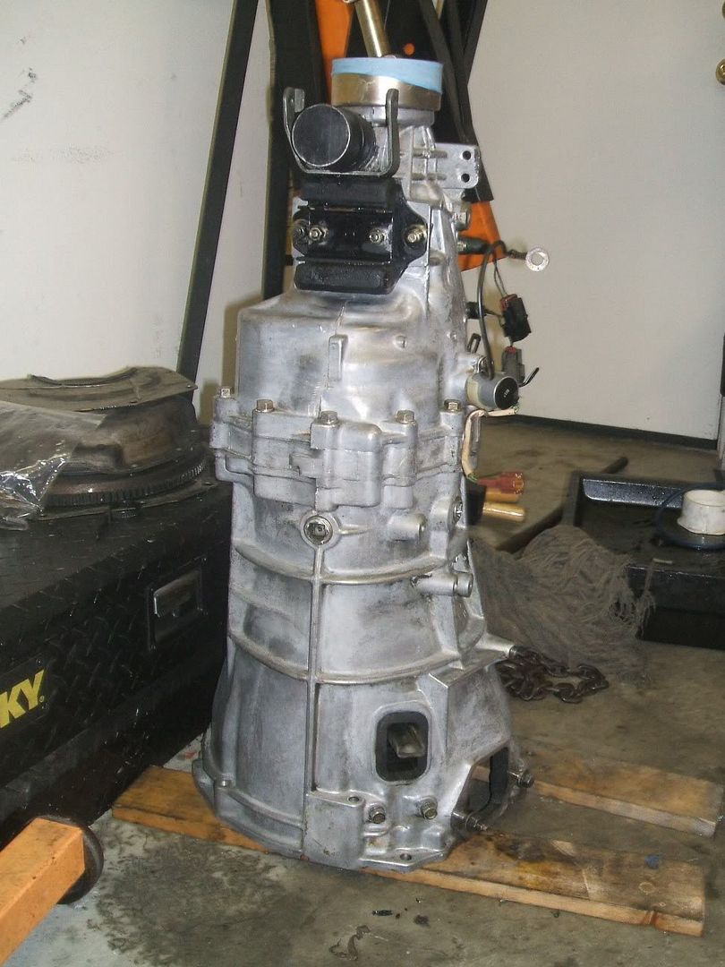

Cylinder Block and Transmission
Parts parts parts

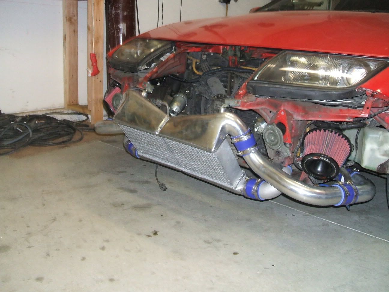

Bardabe....what are you doin' dude? FMIC on a Z32? Have you not been paying attention? HKS might be the best FMIC on the market today, but it's not the best on Z32TT....not by a long shot. From what I've read, Fabtech makes the best lift kit on the market, but you don't see me putting their stuff on my Z. Moral of the story....just because it's the best on the market doesn't mean it's the best on the Z.
What do you mean 'My gauges say otherwise'. Do you have some special gauges that tell you how much better that FMIC is performing in your car than if you had Stillen SMICs? If so, then you need to get some gauges because they're wrong.
he meant with the cooling issues involved with FMIC's his guages read otherwise, and the way that FMIC is setup its basically SMIC's stuck to the front and on an angle, so longer piping is involved overall, seems like not such a good investment, at least it isn't the apollo i guess.....
I think I've already laid into him about this.
The HKS FMIC does retain the cross-flow design, though... unlike the Apollo, the HKS is basically just two SMIC's welded together. So its only downsides are restricted airflow to the oil cooler and radiator.
And as for "being the best FMIC on the market for the Z32"... that's like being the smartest kid with Down's syndrome. I'd rather not make my Z look buck-toothed, but it's his Z so he can do whatever he wants with it.
What i meant by my gauges read otherwise, is that my coolant temperature didn't go up. they stayed in the 150's (Nismo Thermostat + radiator cap) and I don't think Consult would lie to me about that, What the hell I'll have to get an A'pexi Water Temperature gauge or show data logs of the car after i put it back together.
as far as the FMIC goes, i couldn't loose, I have shorter intake piping, custom Fabricated Dual with MUCH MUCH shorter piping. helps it allot (less restriction) as far as IC pipe length goes, yeah it adds some more pipes but i can deal with it, after all they do help disperse some of the heat before it gets to the Intercooler so it's all good.

I will be relocating my oil cooler to where one of the SMIC used to go. I'll be fabricating a braket to keep the stock IC duct to duct air there. I'll be looking at Earl's and Summit racing for a Oil Cooler core that is around the same size as our Stock SMIC's as far as the Radiator goes, yeah it will live. I will be cleaning the hell out of my AC condencer and all other stuff while the engine is out to make sure its clean like when it came from the factory.
Fog Lights ducts yes those are to be ordered as well but I'll be taking care of that when the car goes into paint I'll be getting the Fiberglass ones and painting them black / tinting them the same shade of the JDM turn signals.
and yeah as far as compression numbers go.. eh wooops. either way they where too low, too damn low for my standards. plus my pistons looked filthy with all that carbon build up. (thank you NGK BKR7ES-11 or whatever it is specilaty Z sells) I'll be getting some PFR6B-11B's and calling it a day.
Im still looking for a machine shop that i can trust to do my Engine block and Head work. The machinists i used to use for my RB's and SR's is not in SoCal anymore so i must keep hunting. in the mean time i will be cleaning all other parts replacing my Wiring harness and cleaning the hell out of my engine bay. also going to weld in a new battery tray if i can't repair mine its starting to rust.
^^^ I like my battery where it is, plus if i do put it in a box in the trunk. the track will start giving me crap for putting a kill switch on my dash where it can be reached from both sides of the car. eff all that. battery sits nice in the OEM tray.
I have to agree. your gauges might not read the temp any different but you are blocking some of the things mentioned (rad, oil cooler) and you realize that. As far as moving the oil cooler to the side, i don't think it might be as effective with the oem bumper and you still have to make brackets and hoses to make it fit

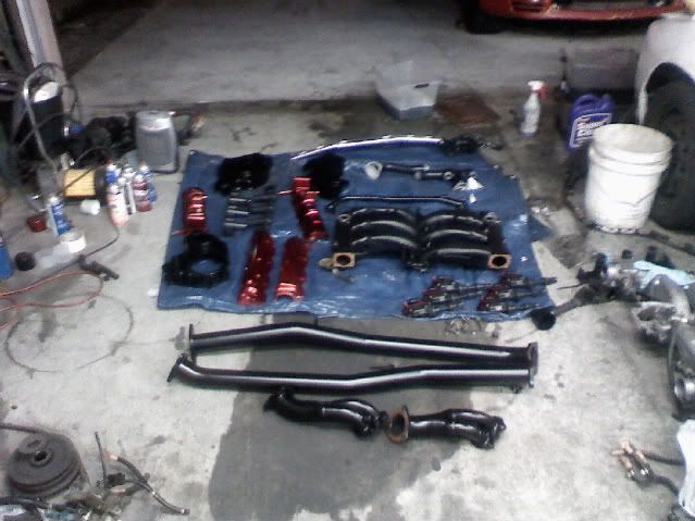

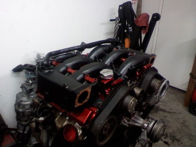

today however was a very good day for me and my Z. morning i degreased, cleaned and cleaned my engine bay some more. then i Installed my new wiring harness. new wiring harnesses are awesome. after that, i started cleaning and preping parts for paint. and set them aside.

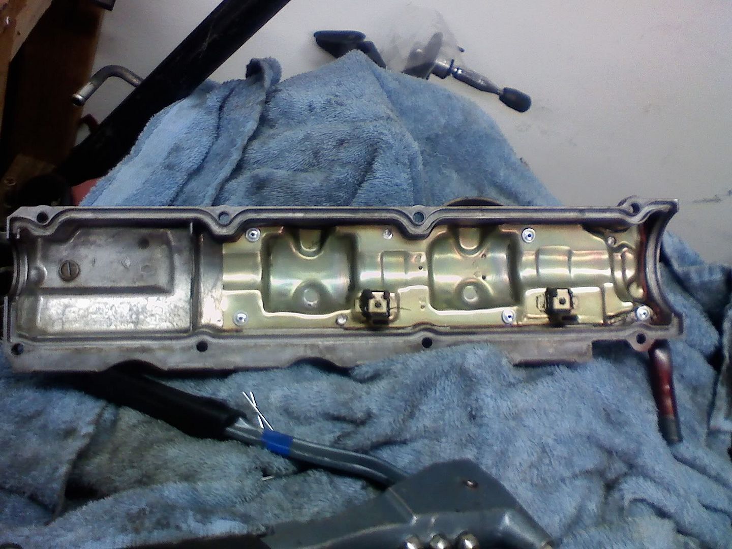

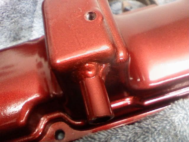

I took my new JDM valve covers and redid my PCV bypass mod. here are the pictures. I tig welded some 3/8 aluminum tube to the valve cover much better than the typical drill and tap NPT fitting.
then i painted them
along with everything else
while all my parts where drying, i took all the parts i had been cleaning and bolted them up to my block

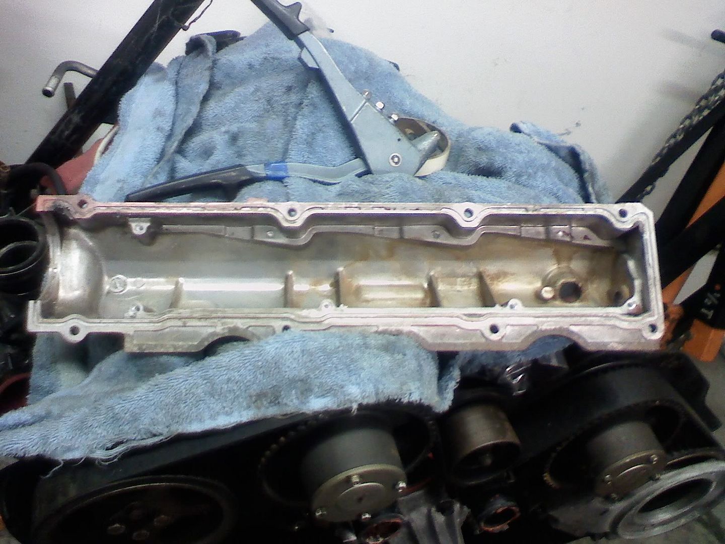

then i took the valve covers did the stainless steel scrub mod, but instead of drilling and taping the under trays back on. I riveted them back on.
I bolted the valve covers back on at the end of the day. and over layed the plenum just for ***** and giggles. looks awesome / good IMO.
then i painted them
