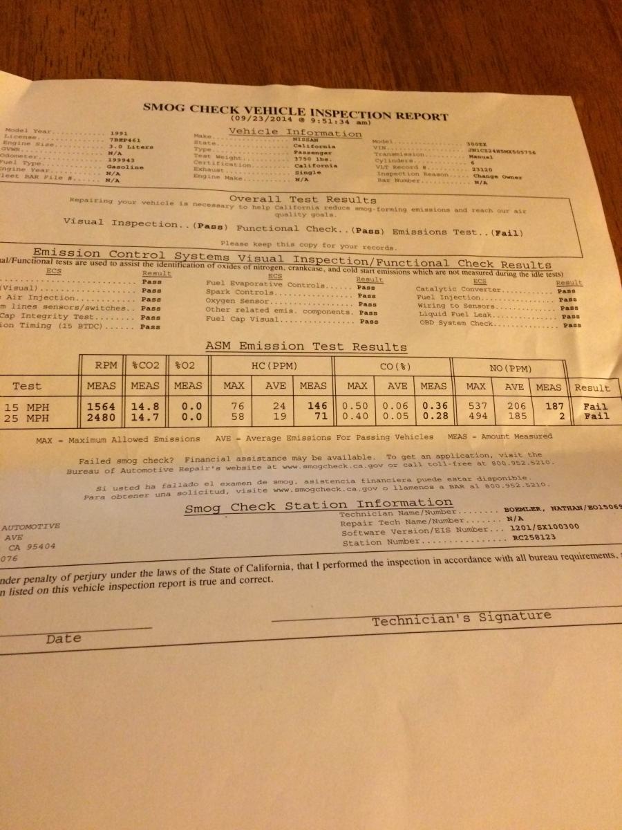

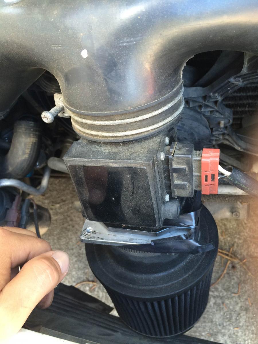

So here goes it.. I have 91 300zx TT and it wont smog.. This is what I know about it since Ive started working on it. The ecu and O2 sensors were the first thing I changed out. (ECU wasnt displaying the CEL) It seemed to help my fuel consumption and I put new Cats on it as well. Ive had Z cars before (lemans sunset 350z track). This is my first turbocharged one. Mods are; HKS Catback, some shitty intake which i think is the problem and Greddy BOV's. Now Ive done some research and when you run BOV's it can cause a rich condition... How do I remedy this? Also I'm in the market for some stock or better re-circulation valves as I am not a huge fan of the loud noise everytime I shift. Plus apparently they are more efficient then aftermarket ones anyway???
I have pictures of the results from both failures. Annnd this is what I found after I took a look at the intake wtf!?

My bad here they are and smog results from the last time I went.

So anybody have any thoughts? Im replacing the intake this week figured I should start there.
