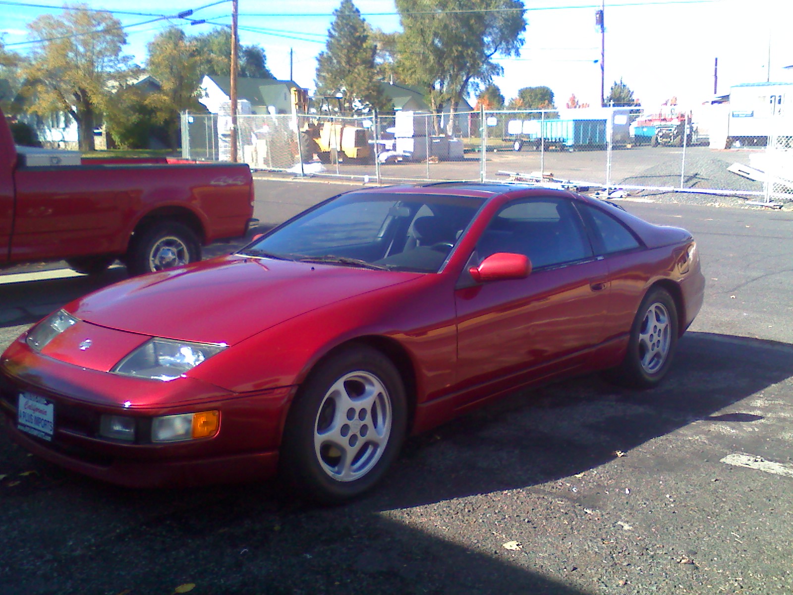

I have a 1993 300ZX 2+2 NA with AT. Purchased 2 years ago with 117K miles.
