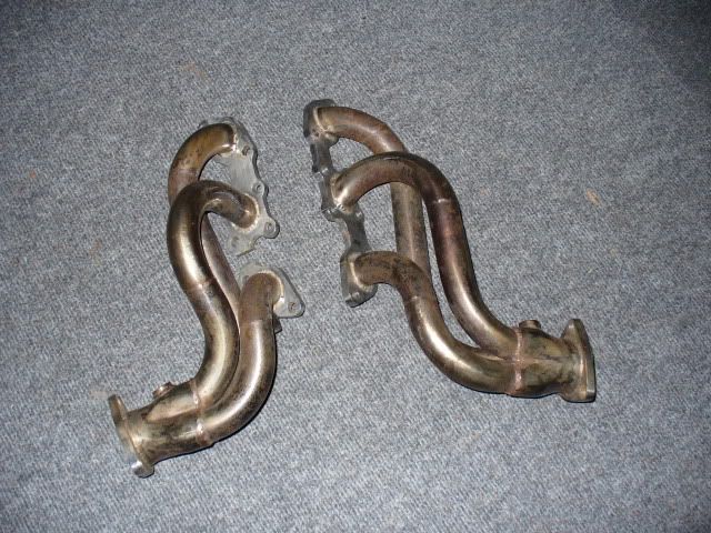

right at the end of the headers are the 02 bungs
