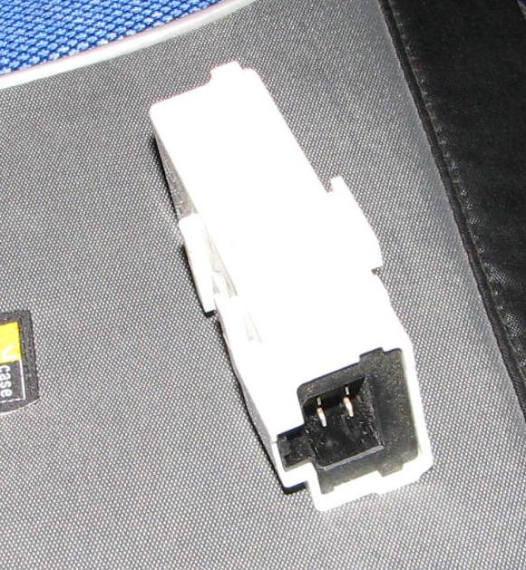

There is a tail light doohickey(stop and tail light sensor)
IN the back of the car, behind the panel that hides the tail lights is a little rectangular box, they can vary in color, but I think they are all mostly the same, could be white or green. it could be bad or a corroded connection.
I have a few spares, not sure where they are exactly, but I do have some if you can't find a replacement, if thats the issue

a few picture
here is the white one I have, give you an idea what to look for
