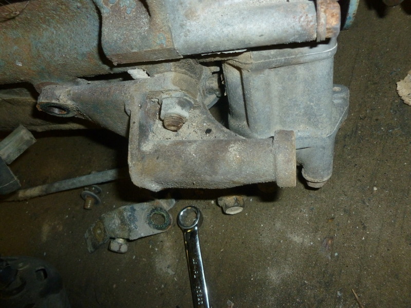

OK, there is actually no solution to this issue other than, making sure you have a clean earth and your signal wires have clean contact, if this fails obviously you have serious earthing issues or to much resistance on you signal wire (i.e. replacing those old wires). If you have any of these problems your going to get a dead alternator.
My favourite one is the GM 1 wire trick or mod what ever you want to call it. That is a definite fail proof solution.
So my question is does anyone here make L28 GM alternator brackets for purchase?
Alternator Eating Issue
Check those grounds, make sure the engine small black one connected via the heater hose clamp is connected with good contact to the block not the clamp, I just busted another alternator, then i fixed the gorunds and it seem to be running well now, thanks for those pic's defiantly a great mod. I ruined an alternater but repco here in Brisbane replaced it for free.
