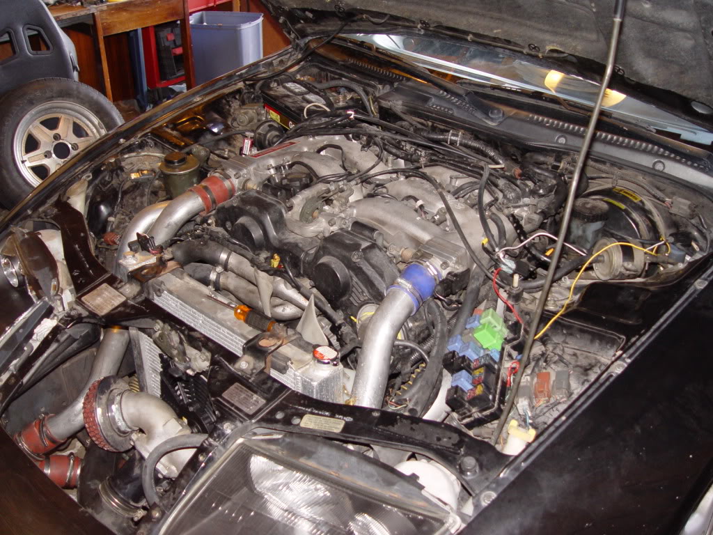

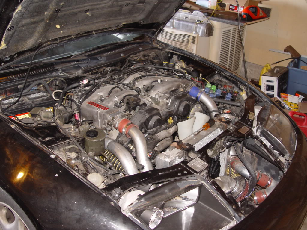

On this last pic you can see the small oil puddle under the Ic boot.
And this is this annoying 300ZXTT I've been working on.

There is a fan in front of the radiator/condenser that operates almost exclusively when the AC is on. It is not relied upon for maintaining engine temps.
You absolutely need to figure out how to get a shroud on there. A fan without a shroud will draw air from the wrong places... i.e. not past the radiator.
And from the pics, that car is ****ed. Burn it, file an insurance claim, move on. lol

Ok thats news to me.
And I'd love to. if I could. I know it wont fit behind that radiator. that fan scares me with how close it flexes to the radiator to start with.
