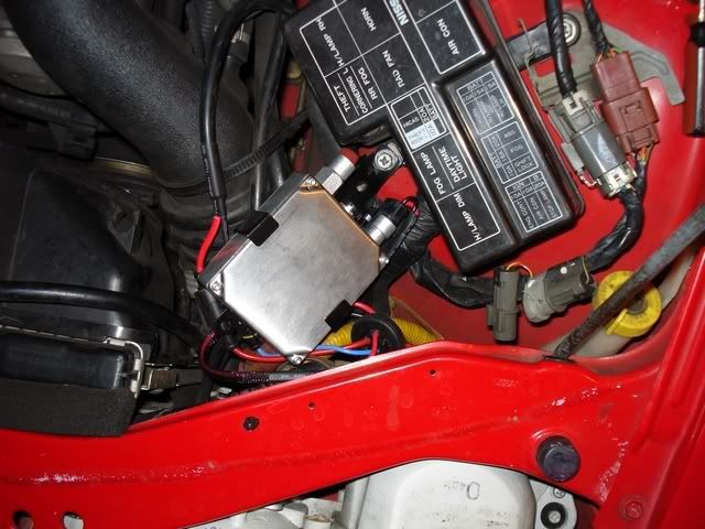

Installation is very straight forward.
1. Install bulb into headlamp assembly.
2. Connect power connector extension from HID kit to factory lamp connector.
3. Connect opposite end of power connector extension to HID ballast.
4. Connect HID ballast harness to HID bulb.
NOTE: The power connector extension had the + and - backwards. I turned the connector around as pictured above and it works. Be careful though, on the other side is a larger piece of metal that the connector latches to. If you force it you could break the connectors latch.
Location:
I've seen a few posts where people bolt the ballasts next to the air filter. The wiring in this kit wasn't long enough so I needed something closer.
Drivers side:
Passenger side:
Results:
Drivers side: HID
Passenger side: Halogen
Note: The SUV has standard Halogen lamps.
Conclusion:
The ballasts emit a slight humming noise when activated. You can only hear it when the car is turned off so its not a big deal. The pictures make the HID look a bit bluer than they really are and the halogen quite bit whiter. In reality, the halogen lamp is more of an amber color. I don't really see these as high beam replacements because of the narrow spread, but they do improve visibility and that was the whole point of this install.
I hope some of you can find this writeup useful and feel free to post any questions.
