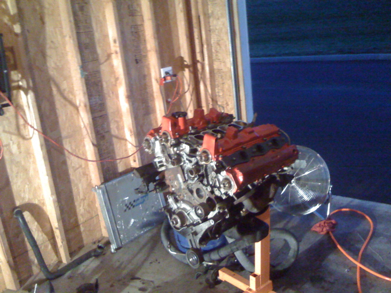

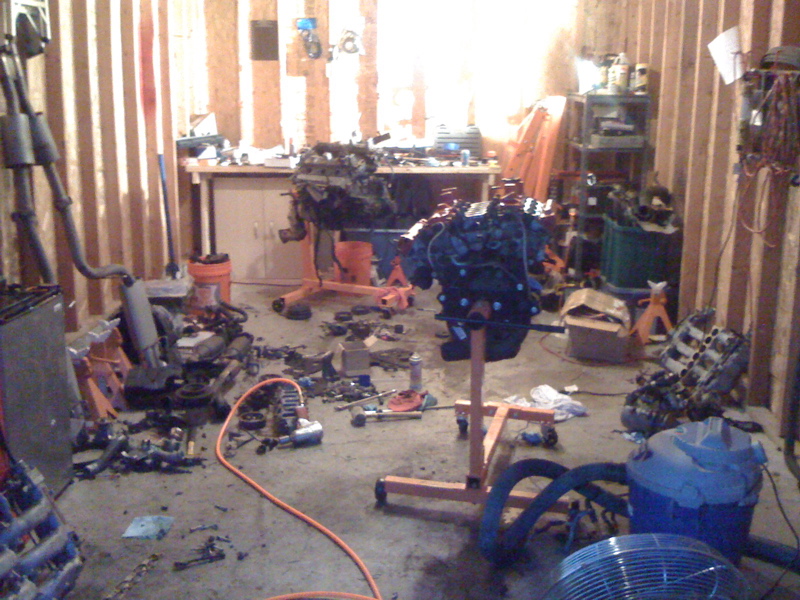

A couple pics from my current project
I'm doing two engine builds one for now and one for later. What a mess two engines make when you run out of desk space.
Attached Thumbnails A couple pics from my current project-img_0074.jpg   A couple pics from my current project-img_0076.jpg

Engine 1 and 2
1 is going back in the car next weekend after I get some parts and finish assembly. Its basicly stock But it has been freshend up with all new hoses, new oilpump, sender, some new sensors injector o-ring kit and a 60k kit.
2. is going to get fully dissasemmbled and going to the machine shop for porting, polishing, line honed, overbored, getting forged pistons, lighter rods and becuase it spun a journal it might be getting a new crank depending on the damage.
When I reassemble that one it's going to get either gt675s or JWT700s, not sure yet but it will get 555 injectors and mild cams. I'm shooting for 600hp at the engine.
The car already has upgraded SMIC, intake, exhaust and boost controller, so the groundwork has been laid.
