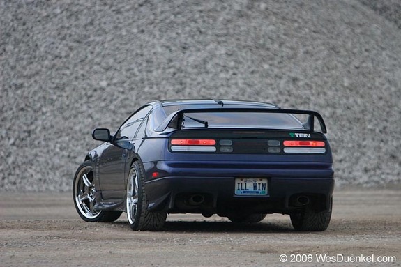

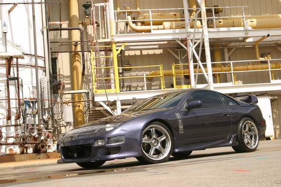

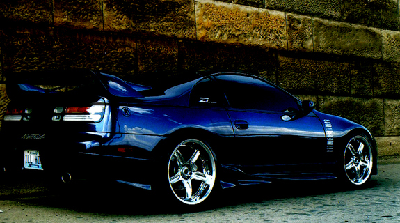

here's what ya do
Get a 2x4 and put it across your spare tire, measure the distance from the 2x4 to the center of the wheel,subtract the distance of the rubber sitcking past the rim, that should be your minimum offset cause the spare is supposed to work on all wheels. Remember to think metric you will find it to be about 30-32mm (or should be) if you want a bigger rim say like a staggered look you will want to split the differnce say front is 40, but rim is 9 tire is 245, back is 10 tire is 275 differnce of 30mm but you don't want the rim to stick out much further but still want a wider lip on the rim.....you will go about 15mm so 35+ 15 is 50. Here is the catch... you are going for staggerd wheels, front offset is bigger to accomodate bigger brakes, rear offset (minimum is smaller) the book (NISSAN) manual says front is 45 and rear is 35. Aftermarket wheels tend to split the difference hence the 38-40. but they get away with that because people normally go with bigger wheels, think salad bowls, bigger the bowl the smaller the need for a larger offset. This is why some rims need more offset than others. Flatter backs on rims (usually cheaper rims) mean you will need a bigger offset. VOLK are pretty high end, they will use as little metal as possible cuase they also use expensive metal. Because they use stronger alloys they need less metal and becuase they can, they use curves on the inside of the rim therefore they need less offset. If you can follow all this then you can make up your own mind on offset based on what you want your car to look like. Following pictures are of Volk wheels at about the same measurements you want. Staggerd, and if i do say so myself, looking damn good.
Attached Thumbnails 300zx TT Axis Hiros???-2056686_137_full.jpg   300zx TT Axis Hiros???-2056686_150_full.jpg   300zx TT Axis Hiros???-2056686_105_full.jpg

back again :)
If you look earlier in this thread response 67 you will see some pics of 18s on the Z the front tire is 245 40 18 and the back is 275 40 18, also posts 69-73 kinda explain the theory the guys at Tirerack subscribe to about different sizes. If you measure on the picutures between two lugnuts (for reference to your car) and then center of the wheel to the top center of the wheel well you can see what the clearence would be for your car. Pictures are of an aftermarket suspension set up so you will have to make your measurements to figure out the difference (a little math, proportions and fractions, oh my!) between stock and custom.
