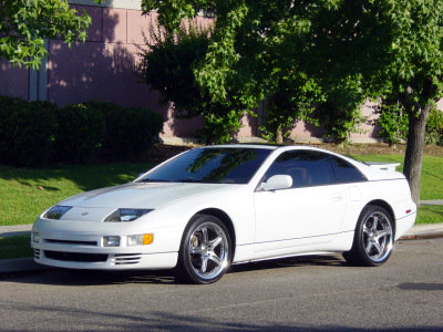

What do you guys think about the volks on this Z?
Old Mar 22, 2007 | 10:33 AM
nice, a little to chrome for me, but nice. i LOVE these volk wheels, it was what i wanted if i ever got a TT cause not worth the money on my NA and now i got a S30 sooo.... yeah but here

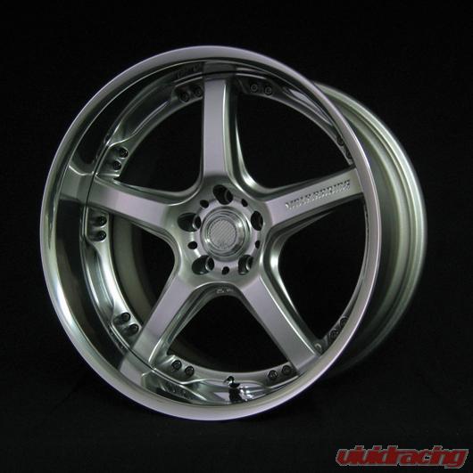

Damn, I just found some bada$$ wheels, but they don't make an 18 for the front. Volk GTS. God hates me. I guess it could be worse. I could be driving a V6 camaro.

hmm, ill check the site again, i think that color would be killer with black or silver but its all in taste... lemme' take a look for yah.
EDIT: sorta like this?
here is the site im using for volk wheels, not hte site i usually use but it seems to get the job done.
http://www.mackinindustries.com/md/index.html
and yeah volk is expensive but damn good, and hell, if you were ready to drop 1800 on headlights or w/e the cost was i think the price of volk wheels shouldnt faze you to much
and here is volks official site i guess. http://www.rayswheels.co.jp/ some of it is japanese though. lol

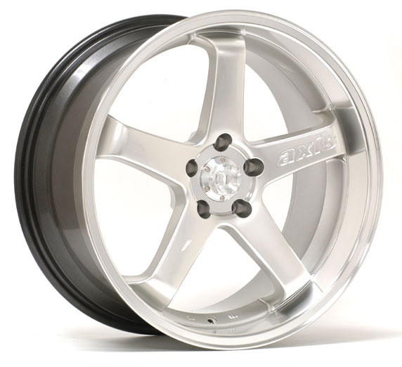

Something a bit more silver like this.
Attached Thumbnails 300zx TT Axis Hiros???-axis_hiro_nissan_350z_2_.jpg   300zx TT Axis Hiros???-silver.jpg
