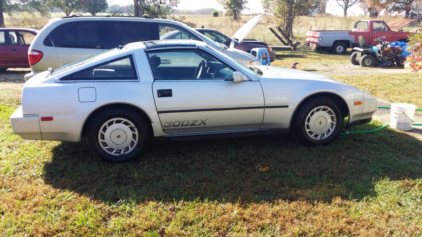

Yeah. Its a solid machine. Like you said, I just have to make up for all the neglect. Its gonna be killer when I'm done. I'm more of a body guy, so once I get it operating correctly I can really get into it. Ive always wanted a Z and this is my first, so its gonna be my baby.
Attached Thumbnails No engine noise but no power and backfire.-20141026_150545.jpg
Old Nov 24, 2014 | 02:46 PM
zxguy1986's Avatar
Joined: Aug 2013
Posts: 1,103
Yep! That's the Z. How about a pic under the hood? Thanks.

Old Nov 24, 2014 | 02:48 PM
Zedsdead's Avatar
Joined: Nov 2014
Posts: 12
best 300 bucks i ever spent.
Old Nov 24, 2014 | 03:15 PM
Skully's Avatar
Joined: Feb 2002
Posts: 2,906
From: Saskatoon, SK
Looks really good!! Awesome!
